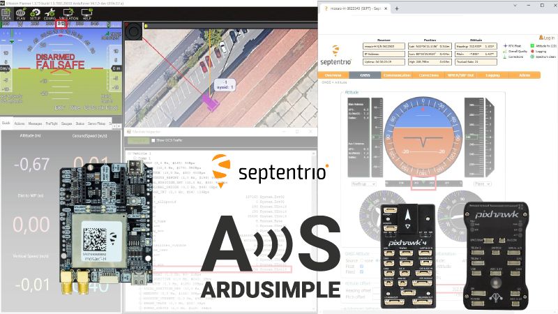

I recently completed the assembly of a quadcopter using Cube Orange+ and a Septentrio GNSS receiver that is set as heading source.
I installed Arducopter v4.3.7 from Septentrio that adds SBF heading support and configured it. In Mission Planner and on the GCS I can see all GPS-related data correctly (photo) and the vehicle icon appears accurately on the map. If the drone is manually moved the icon seems to accurately follow the UAV movements.
The problem is that, even with a reported ā€œ3D DGPS Lockā€ when switching to ā€œPosition Modeā€ flight mode I get stuck with the error message ā€œPreArm: AHRS: Waiting for homeā€.
I also noticed that although the indicated ā€œGPS Yaw (deg)ā€ corresponds with my smartphone compass readings (pictures), and the vehicle’s icon on the GCS and Mission Planner ā€œspinsā€ precisely accordingly to the vehicle yaw changes when manually moved, the heading displayed on Mission Planner’s map is completely off (photo).
I’m not sure if the two issues are related one to the other, but I would greatly appreciate if anyone could help me figure out this two issues. I literally cannot wait to start flying!!! :star_struck:

Update to the latest 4.4 firmware (support remains in the updated versions).
I found this guide very helpful:

Probably incorrect antenna orientation, which can be changed via the USB interface.

Actually, it appears I was incorrect. That patch is still ahead of AP master and is not yet included in the ArduPilot repo or builds. I mistakenly thought that it had been merged.
The guide from ArduSimple overcomes this by using NMEA formatting, and I can confirm that it works.

I went through your parameters of both files and saw something odd with the GPS_PRIMARY. The only serial port that is configured as GPS is SERIAL4 (aka the port with label GPS2). So, I assume that’s your first (and only) detected GNSS system. However, the GPS_PRIMARY (Complete Parameter List — Copter documentation) is set to ā€˜1’, the second detected GNSS system.
Can you set GPS_PRIMARY to ā€˜0’? Maybe this will switch the GPS and GPS2 data.
