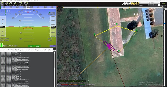

In my case, the rover needs to return home for resupply. I’m working on an RC vehicle that spreads minerals along a mission route. When it runs out of minerals, it should return to the home base for a refill, then come back to the exact spot where it ran out and continue spreading. This way, the operation can proceed smoothly without missing any sections.
However, I noticed an issue: if the rover passes waypoint 1 and is on the way to waypoint 2, and it runs out of minerals, it triggers RTL but then heads straight to waypoint 2 after resupply, rather than returning to the exact spot where it stopped, as shown in the figure I attached. Would your approach still work in this case, or would adding a waypoint at the stopping point be more appropriate?

Thank you so much, EosBandi. For the past 4 hours, I’ve been working through Yuri’s code, trying to understand it and making a few modifications. I removed the “should ensure takeoff is complete” part since I’m working with a rover, and I also removed the battery failsafe condition.
My purpose is to get ground velocity >4 so then it will save waypoint at current location and RTL. but when the velocity > 4 it shows “Auto mission changed, restarted command” then go in circle.
Here the lua code that I have modified:
test.lua (5.0 KB)
And here is the figure and message that it sent and also what it sent through message:
ErrorMessage.txt (5.7 KB)
I feel like I’m close to getting it right, but I’d really appreciate any help or advice if you have the time. Thank you so much to everyone for the support.
Hmm, didn’t you forgot something from the two actions above ?
You still running the mission in auto mode when the script rewrites the script. There is no RTL command anywhere…
Thank you Eosbandi, I really appreciate your help, it now worked thank u very much
