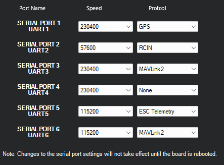

Hi!
I’m using GEM1305 receiver with ArduCopter V4.5.7 (2a3dc4b7). The connection to flight controller is standard, nothing special: 5V, RX, TX, GND.
Arducopter (relevant) config parameters:
SERIALx_PROTOCOL = 5
GPS1_TYPE = 5
Serial speed was set to 230400.
Flight controller can receive data from GEM1305, but the PreArm: GPS signa is unhealthy. On the HUD I can see that the GPS sees only 3 satellites.
I tested the GEM1305 with a standard USB-serial converter and Satrak software. The GEM1305 was able to see 50+ satellites.
Can you please help, what other settings do I have to perform to be able to use more than 3 satellites, and to be able to Arm the drone?
Thanks!
@datagnss
Hi Peter
Please disable gps auto switch.
Then choose GPSx as the only GPS.
Hi!
Thanks for the fast reply!
My serial setup looks like this:
Where can I explicitely set up, that the flight controller shall use only one GPS1?
GPS_AUTO_SWITCH = 0
GPS_PRIMARY = 0
Do I have to set any more parameters?
Thank you!
Yes, please config above two options.

Hi!
I have set the above mentioned parameters but GPS is still unhealthy :frowning:
The drone logo in MissionPlanner map is at the right position, where my house is, this is OK.
Maybe I need to lower the PreArm GPS health status check limit?
Let me copy the output of message window, maybe it contains important bits:

Please try to lower the check for PreArm or disable this check.
We will check the 4.5.7 code too.
No, don’t disable GPS prearm checks. You can relax the HDOP threshold if necessary, but do not simply ignore warnings.
