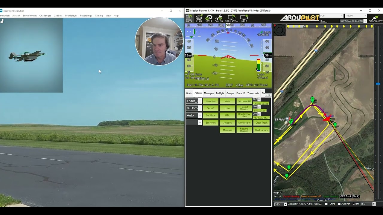

The 4.4beta version of ArduPilot plane firmware has payload place support. This allows for missions where you can drop a package at a location then continue the mission to come home. It is designed for logistics or medical delivery applications.
The above video gives a demonstration in RealFlight with MissionPlanner. The key things you need to know are:
You will need a mission like this one:
The PAYLOAD_PLACE mission item is treated like a VTOL landing with all the usual back transition logic, but it has special behaviour where after the package is released the aircraft climbs back up to the approach height and continues the mission.
You need to setup parameters like this to setup the payload place lua script:

Unfortunately the altitude loss during the VTOL to fixed-wing transition after the PAYLAD_PLACE is still happening, even in SITL on MP :confused:
Video from SITL and mission here: PAYLOAD_PLACE - Google Drive
I’ve also got a SITL log from the missions flown with the PAYLOAD_PLACE: 2023-07-01 11-28-03.bin - Google Drive
Any ideas?
thank you! That log helped me find the bug and the fix is here:
we should get this merged in a couple of days, and will include the fix in 4.4.0beta3
When you have the fix, some other things you need to do for SITL testing:
Thanks again for finding this issue and my apologies for being slow to see the problem. The SITL reproduction was very helpful.
Cheers, Tridge
