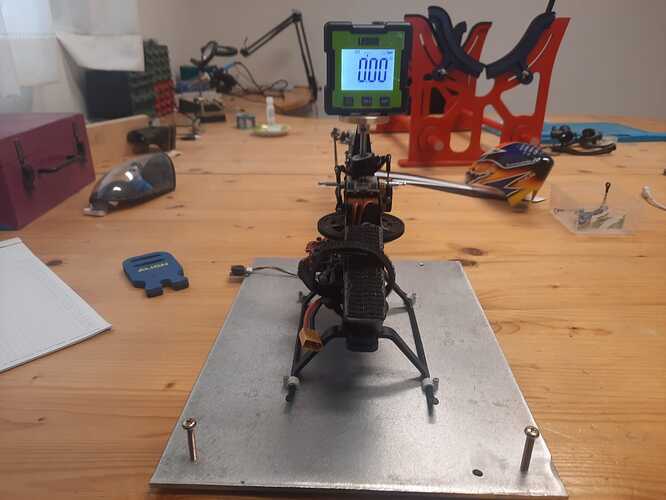

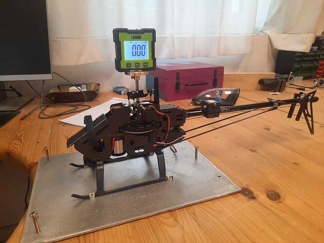

I read and followed the wiki, but 6 degrees seems excessive to me. I would not want there to be some mechanical or electronic setting problem.
How well balanced is your C of G? Was the mast perfectly vertical when you leveled the swashplate and set the blade angles? How level was the airframe when you did the initial IMU leveling? There’s a lot of variables. Yeah, 6 degrees is a bit, so you can go back and check everything else first.

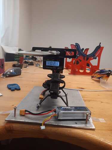

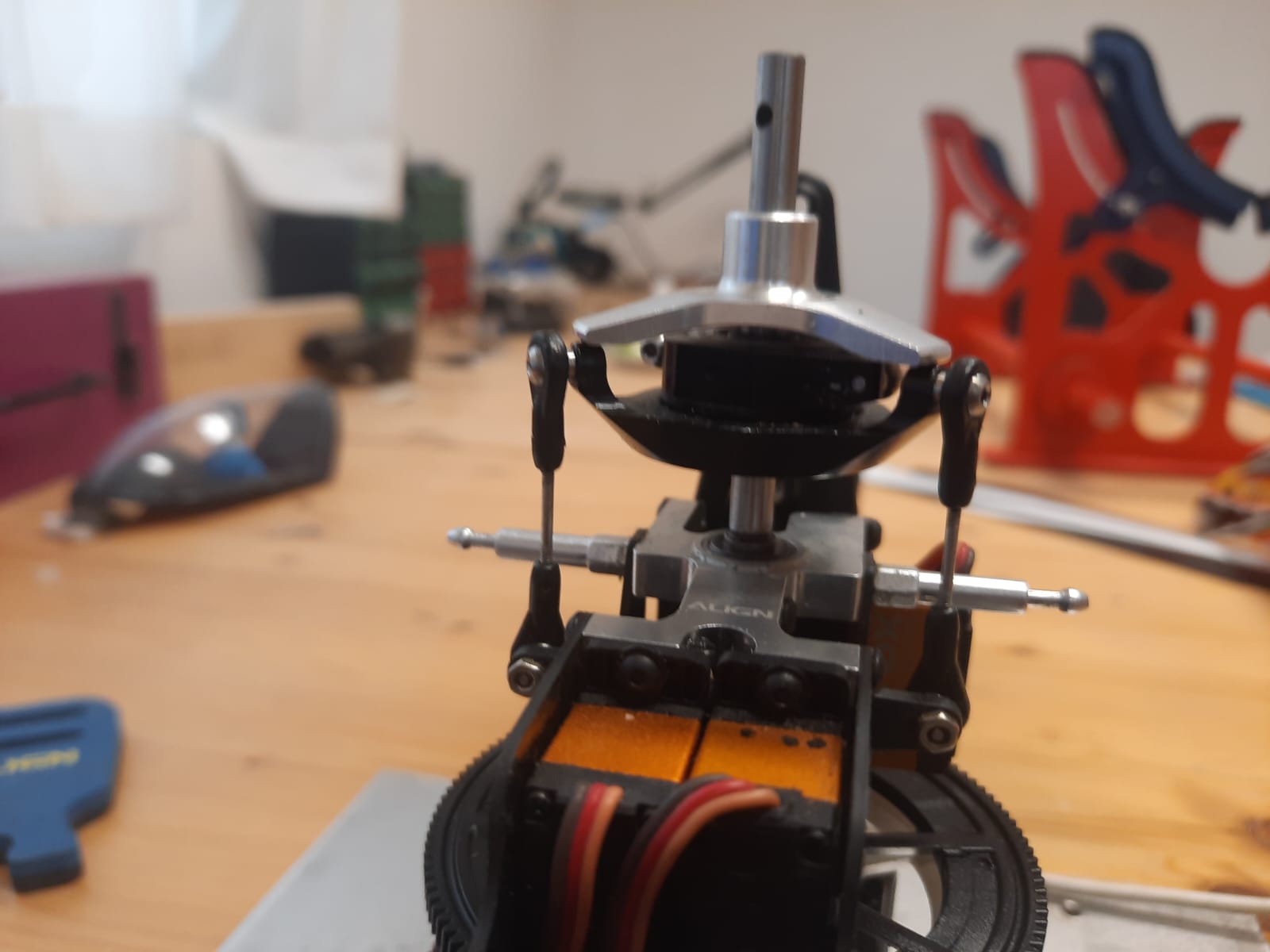

Hi @bnsgeyer, I put the mast perpendicular to the ground and I configured the “Max Collective” to 10° and the “Min Collective” to -2° as indicated in the helicopter user manual. But when I bring “Zero thrust collective” I get the value of -2.0°. I don’t think this is correct. In this configuration I should get the value 0°; right? To position it correctly I have to act mechanically; right? Thanks
Walter, Yes you should see 0 deg or within +/- 0.2 deg. When you set the max and min collective, you used the Manual collective servo setting (H_SV_MAN) to move the collective to min and max? Then the H_SV_MAN set to 3 to have it show you zero thrust collective?
Hi @bnsgeyer, exactly, I acted on the H_SV_MAN parameter as you described. I redid the max and min incidence after mechanically extending the rotor levers, so I obtained the 0° value. Today I performed a flight in howering, but it seems that the value to insert in AHRS_TRIM_Y is always around 5/6°. I leave you the flightlog; if you can analyze it I would be very happy.

Walter, Yes, that is correct. Because your flight controller must be mounted such that it is 5-6 deg off of the plane perpendicular to the shaft. I guess it could be a CG thing but my bet is on the mounting of the flight controller. just set the AHRS_TRIM_Y as I requested above. You should be fine then.
Hi Bill, thanks for your support. I attach the flight control position on the helycopter. The GC is exactly vertical to the main shaft.
Thanks
