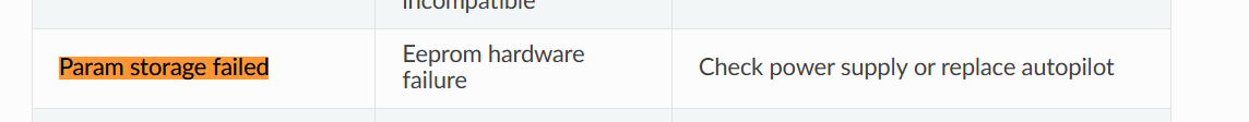

Pre-Arm: "Param storage failed" error on Mission Palnner
  • Hello, I am using ArduPlane with a CUAV-X7 board. I have added a new serial library that receives the data, copies specific bytes into variables, logs, and sends them on Mavlink. I have added a scheduled task (Frequency=10Hz, Time=400, Priority=97) in the Plane.cpp.
  • After connecting CUAV with Mission Planner, I am writing parameters(Serial4_Protocol=51, Serial4_Baudrate=115200). After writing these parameters, I am facing the error Pre-Arm: “Param storage failed”. This error unable me from writing some other parameters after rebooting.

Please share .bin log file with LOG_DISARMED enabled and your changes, I would guess you added a parameter that collides with an existing one.
Pre-Arm Safety Checks — Plane documentation

Dear LanoAstur,
I have replaced hardware, even I have even changed the board to Pixhawk6C. I have also checked the power. But the error is not resolved.
I have noticed that when I upload the default firmware or any other updated firmware, the error doesn’t appear.
Please help me resolve the issue.
Regards,
I have solved this error. This error was due to the manual definition of the class singleton pattern. I resolved this issue using the automatic singleton pattern.
