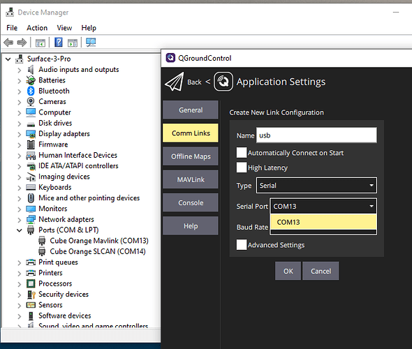

An odd thing I noticed when I installed this firmware was that the two COM ports (MavLink and SLCAN) were reversed. Normally the MavLink com port is one number lower than the SLCAN com port.
Mission Planner had no difficulty with this - all you had to do is make sure you selected the COM ported labeled as MavLink.
But I ran into a problem with Qgroundcontrol. It would only recognize the COM port for SLCAN- which was a lower number. It won’t connect to this.
So I went into the device manager, and switched the COM port numbers so that the MavLink COM port was one lower than the SLCAN.
Qgroundcontrol would still not recognize the COM port for MavLink - so I could not get a connection via the USB cable to this copter on Qgroundcontrol using the 4.5.5 beta.

It shows both Mavlink and SLCAN in Device Manager and Mission Planner though right?
Yes.
At first, SLCAN was COM4 and MavLink was COM5.
Using Device Manager, I switched them so MavLink was COM4 and SLCAN was COM5.
This didn’t make any difference in Mission Planner - both COM ports showed up and I could select either one.
But in QGroundControl, only the SLCAN port shows up - even though it’s now the higher COM port number.

@jstroup1986 I am running in to the exact same problem. Did you ever find a fix for this?
It is not AP but a Windows issue.
  • While disconnected from the FC
  • open device manager (right click on start menu and start device manager)
  • Click on View, enable Show hidden devices
  • Look for COM ports for SLCAN and Mavlink
  • Right Click and delete them, but don’t uninstall driver
  • Reconnect the FC
  • if the order is still wrong, then right click on the port in device manager
  • Select properties, Port Settings, Advanced
  • set a com port number that suits your ordering
  • windows will keep that number for subsequent connections

Great! thank you, that worked! I had already tried changing the port ordering to no avail, but uninstalling the com port devices and restarting, did the trick. Thanks again!
For the record, it seems like an issue with the QGC more than anything else. I experienced the same problem with running QGC 4.4.3 and Cube Orange with Ardupilot 4.5.1. Mission Planner had absolutely no problem in connecting to the Cube, but I had problems with the QGC from the beginning, and only in certain configurations (including radios, ETH connections, don’t remember exactly) QGC was able to connect to the autopilot. It didn’t work over USB and most radio connections.
All this time Mission Planner had no problems with connecting in any configuration.
Anyway, your solution fixed my problem @Eosbandi so thank you very much.
