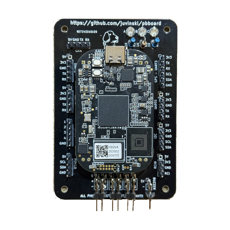

Beagleboard.org has released an upgraded version of the popular PocketBeagle, designed as an ultra-compact, low-cost, and powerful single-board computer (SBC).
PocketBeagle 2 is based on Texas Instruments AM6252 - dual core and a new version was announced with a quadcore AM6254.

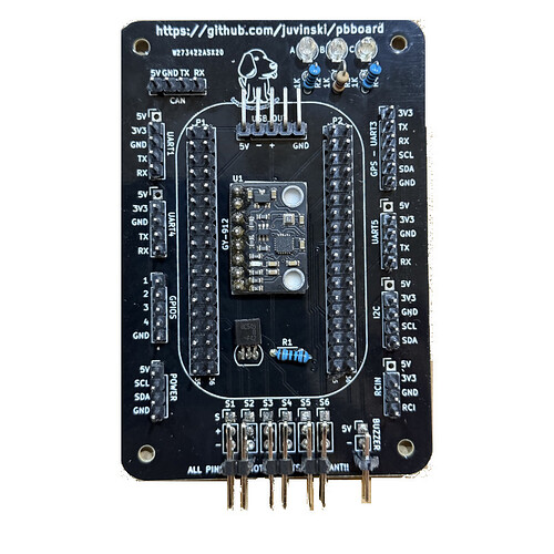

I create a DIY cape, using a GY-912 - ICM20498 IMU and a BMP388 baro in the same breadboard to save space.
To measure battery I choose to use a Holybro PM2D - to save space and the precision, but other i2c sensors can be used too.
There is headers for CAN, GPIO, GPS, OTG.
The PR was merged last week and the wiki page PR will be soon.
The GitHub page for the cape is found at GitHub - juvinski/pbboard: PocketBeagle2 DIY Cape for Ardupilot

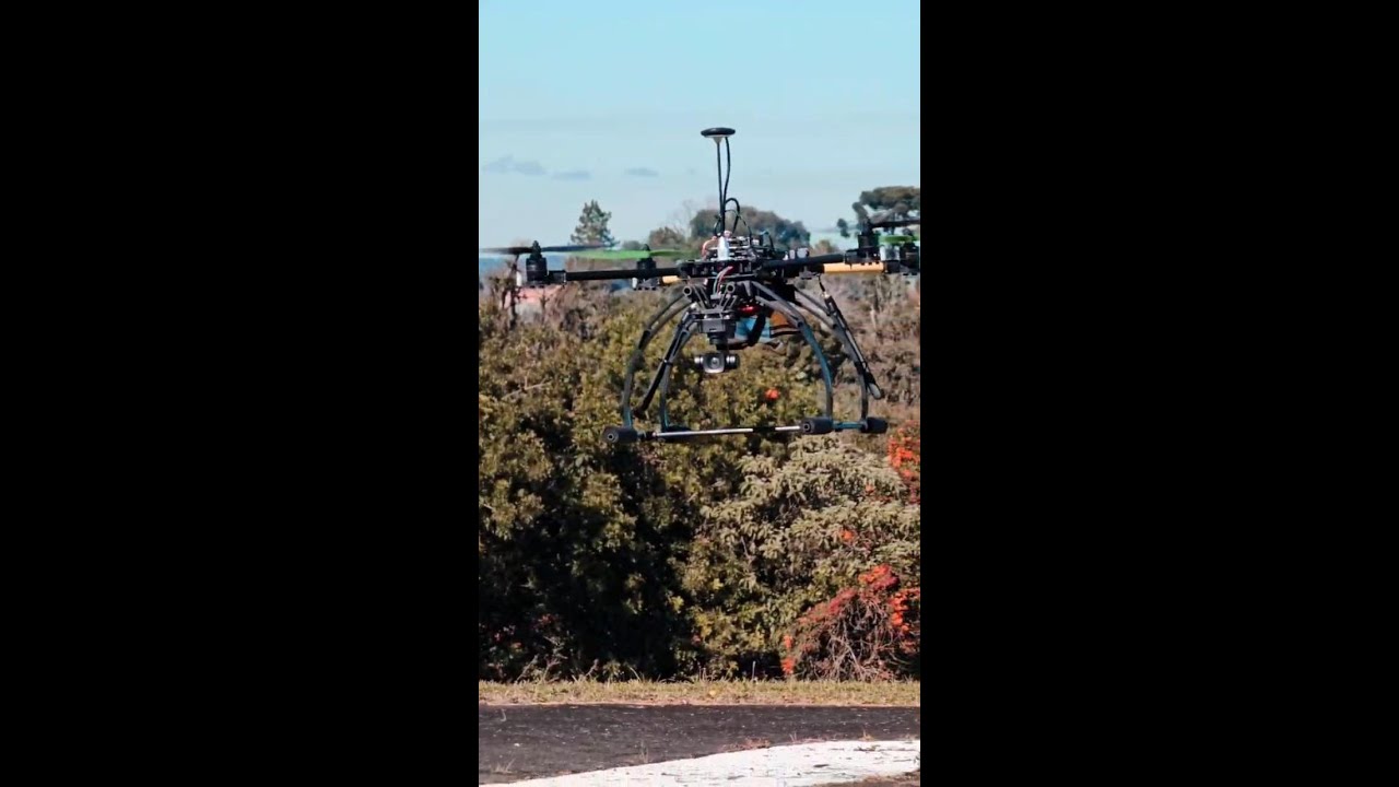

This is the video of the first flight

I never thought about a companion computer but is a quadcore cpu and pretty tiny - with no vision/ai accelerator running Ubuntu or debian

  • What’s the maximum theoretical number of actuator outputs supported? Are all PWM signals generated using the PRUs?
  • Is the HAL based on Linux? If so, does it provide the same real-time guarantees as ChibiOS?
Thanks!
Hi @rzahinos-dev
6 outputs. I have now 6 PWM and testing DShot - without telemetry.
Yes, is linux board runing RT kernel.

does this have the same problem as the old one where the flash will corrupt if you don’t shut it down first before unplugging the battery?
Hi
This is a Linux question not ardupilot, but yes, you should shutdown the Linux - pressing the power button and wait some seconds to the shutdown process completion.
