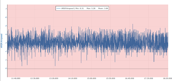

  1. Hello, recently my plane started losing control for no reson in all flight modes including manual. In this clip you can see two of such flights. The log is related to second clip. I want to mention, that i have been using ekf2 in the clip, because i was reccomended to use it instead of ekf3 to avoid the issue. But it did not give me any result. On ekf3 i have exactly the same behaviour, when i lose control and airplane goes into fast spiral descent. Manual mode does not seem to solve the issue most of the time. Also it manages to get out of the spiral, when throttle is being increased.
  2. [00:02]
The servos have been checked and seem to work fine. I assume, that it could be the issue with pwm outputs, but it is highly unlikely. Also there is gps jamming present, so that could potentially affect ekf algorithm flow.

Something is wrong with your pitot, note the CONTINUOUS discrepancies (from -6m/s to +8m/s) with the ground speed. It is clear that they are different things and that depending on the attitude of the aircraft the difference increases, but in this case the discrepancy is continuous and significant.

By the way, these are pre-flight pitot readings. There is an average reading of 2.29m/s.
But after the flight (with the electronics already warm) the average reading is 3,08m/s.
And from everything I mentioned before; the difference between the speed difference (8.81m/s) and the wind speed (5.83m/s) happens to be 2.98m/s which is quite close to the average pitot reading when the plane was stationary (3,08m/s).
What I think is that either the pitot is not well calibrated (arspd_ratio) or it was not properly covered at the time of the initial calibration.
