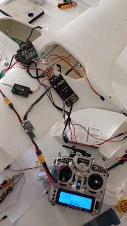

I’m working on a VTOL project using a Pixhawk 6X with ArduPlane firmware. Everything works fine on the MAIN outputs (SERVO1–SERVO8), but all AUX outputs (SERVO9 and above) are disabled in Mission Planner — I don’t even get the green PWM sliders.

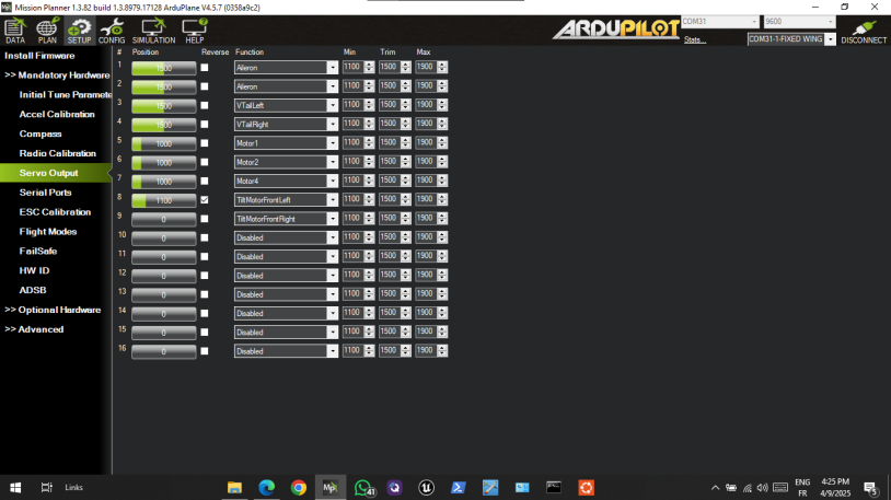

  • No matter what functions I assign to SERVO9–SERVO14, the AUX outputs remain completely disabled.
  • No signal, no PWM activity, nothing in Mission Planner (no green bars).
