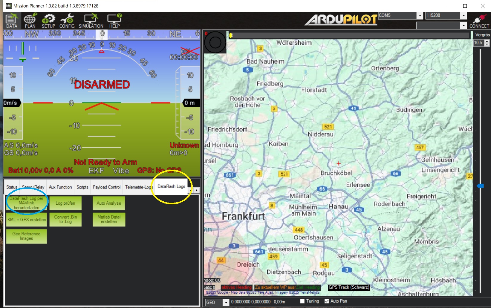

The log.bin file you can get by connecting the FC via USB to PC with Mission Planner. Select on Mission Planner the yellow marked tab and than download the log by the blue marked button. The log.bin file also includes your params.
Upload the log.bin via a unrestricted free filesharing service

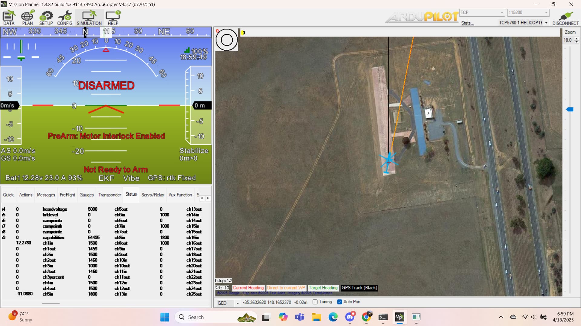

Damien, I never liked the 8-1 encoders. I don’t trust them. Set the RC protocol to 1 (all). Then plug in the 6303 from the SBUS out to the RC in of the Pix racer. use a cord to connect the pix racer to a computer running mission planner and connect to the pix racer. on the Data Tab, select the Status tab in the lower left panel as shown in this picture.
Then scroll over until you see the Ch1in, Ch2in … as I have shown in the picture. move your RC transmitter slowly and verify that the PWM values are changing for the Ch1in, Ch2in, Ch3in, and Ch4in. If those are changing then the pix racer is receiving the RC transmitter signals.
