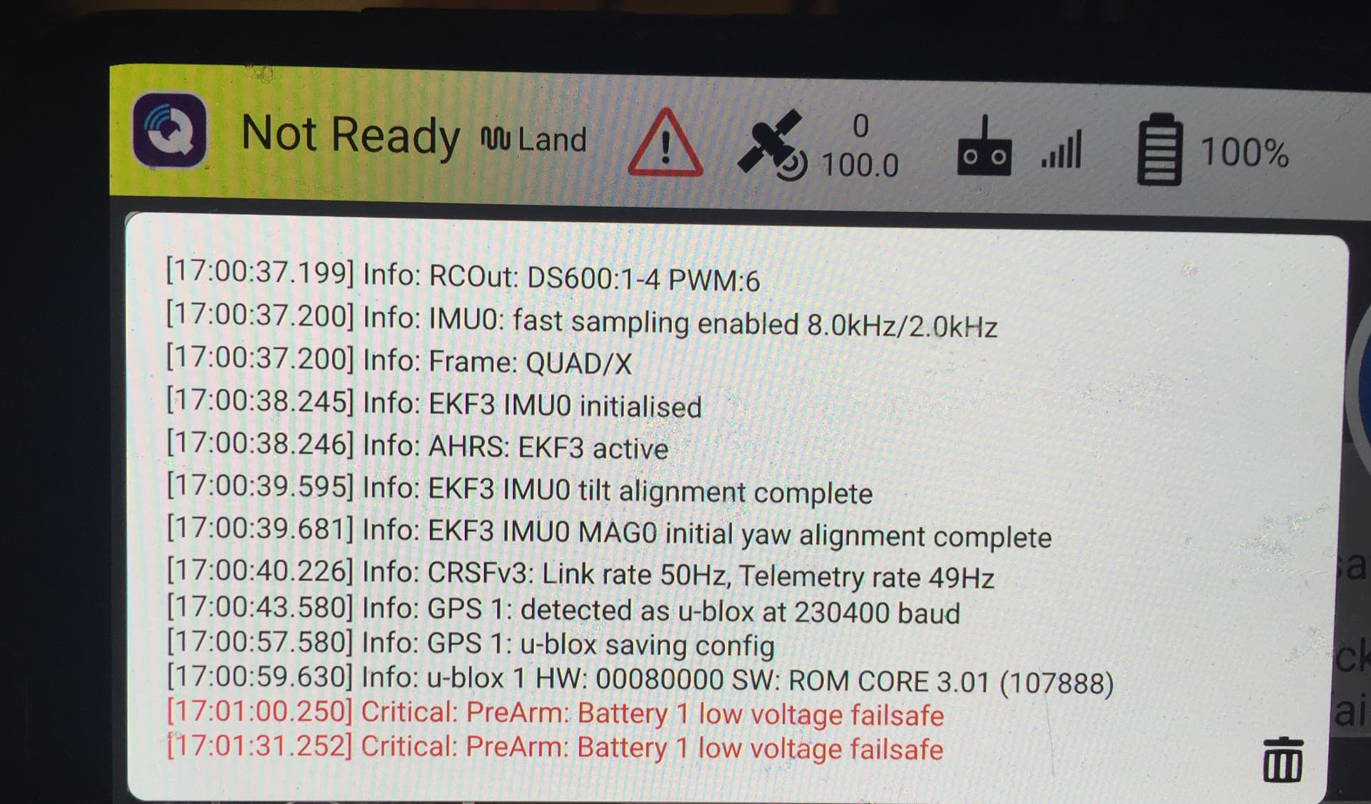

Very slow telemetry update - CRSF - Ethos.
I have done a few component updates over the last few weeks and now have a very slow update rate. The horizon for example, takes about 10 seconds to show a movement. I usually try to fix the CRSF link rate at 50hz but from memory the telemetry was faster before. I can see the ‘sensors’ getting polled at a infrequent rate. Is my memory correct, and it was faster before? Is there anything I could change to improve?
I haven’t tried the 4hz (forced telemetry) rate yet. Would that be very slow?
