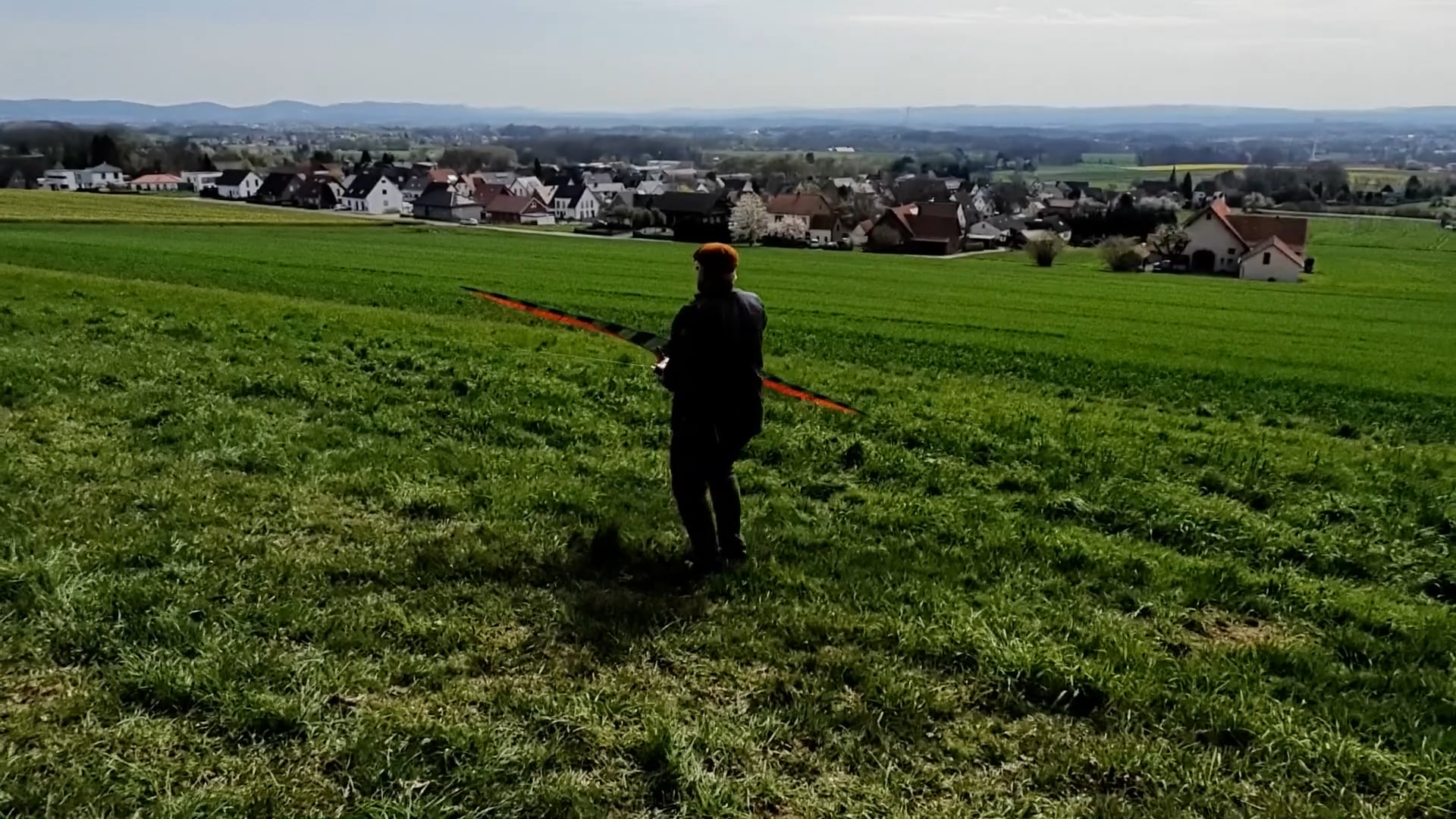

Since we are also interested in dynamic sailing, my friend Matthias has designed and built an ingenious design , which had its successful first flight a few weeks ago. The performance data are impressive. In ground effect it doesn’t like to come down at all.
Can you say something about the aircraft you are using ?
Rolf

Great work, wow I like this plane !

About the plane : I worked with experts in Soaring/ground effect in mountains and slope aerobatics - it’s really specialists business - they are developing very specific planes but very fragile in the same time : so I’ll look for semi-industrial plane, designed for very high winds (F3F planes for example), carbon. But you’re design is really interesting !
