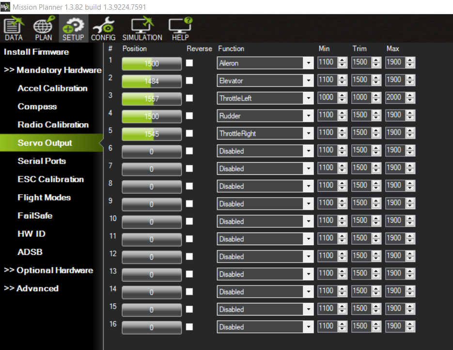

SITL some times has some quirks, but this isn’t one. I just tried a fresh plane setup in SITL and the only thing I did was change the default “throttle” output to “Throttle left” and added on servo 5 “throttle right”. I’ve launched the plane and both are working as expected.

You’re deeper in the code than I am so I won’t argue one way or the other. The only observation on this I have, and you can see it in the screen shot, is the left/right motor outputs are not the same, suggesting to me it’s trying some kind of yaw control. Honestly I was expecting them to be identical when I ran it. From a parameter perspective it looks like it’s working. Physics… I agree you’re probably right.

@Allister, AP always calculates all of the possible throttle outputs, so ThrottleLeft and ThrottleRight exist as “objects” in the background even on a single engine craft. If the default RUDD_DT_GAIN parameter is greater than zero, you’ll see some mixing.
To make sure I understand: this means SITL will tell you if the configuration is working, but because the physics is based on a single motor, it won’t change the flight model.
More or less correct.
The canned simulations in Mission Planner are great for validating auto missions, experimenting with RC channel mixing (assuming you’ve connected a transmitter as a “joystick”), testing Lua scripts, etc. But if you want to modify hardware that has to be physically connected, you need to modify the model in source.
