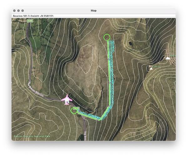

The planner searches within a pre-determined area which can be seen by clicking the Show Boundary button.
Both the start and goal positions must lie completely inside the boundary. The planner region (called the workspace in the OMPL documents) is initially centred on the vehicle home position, but may be re-centred by clicking the map and using the Move Boundary button. Moving the search region can sometimes help the planner find a solution if one of the end points is near the boundary edge.
Click Run Planner to solve for a valid path between the start and goal.
If the path clears the terrain it is coloured green, otherwise red. The small magenta circles along the path denote the states that are connected by the Dubins paths. If the planner cannot find a solution the states representing the best approximation are shown, but no path is generated.
The Gen Waypoint button samples the path and creates a series of waypoints that are sent to the vehicle.

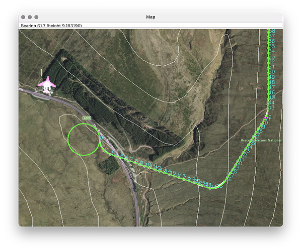

Then use the Fly To map command to place the plane in a loiter at the start circle:
Finally switch to AUTO to follow the path:
The mission has no terminal loiter, and the plane will then attempt a simple RTL, which does not usually end well in steep terrain.
