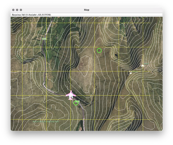

Not all the buttons are functional, the navigation buttons (Hold, Navigate, etc) and Add Rally and Add Waypoint buttons are for a later version supporting an off-board controller.
Show Contours / Hide Contours toggle the display of terrain contours based on the SRTM1 or SRTM30 terrain data made available by the existing terrain module.
Click a location in the map and click Set Start to select a start location. If the circle does not clear the surrounding terrain the circle will be red:
Select an alternative location until the start circle is green.
The terrain contours help to locate a suitable start position.

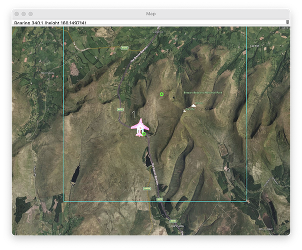

Zoom out on the map and repeat with a goal location:
The planner searches within a pre-determined area which can be seen by clicking the Show Boundary button.
Both the start and goal positions must lie completely inside the boundary. The planner region (called the workspace in the OMPL documents) is initially centred on the vehicle home position, but may be re-centred by clicking the map and using the Move Boundary button. Moving the search region can sometimes help the planner find a solution if one of the end points is near the boundary edge.

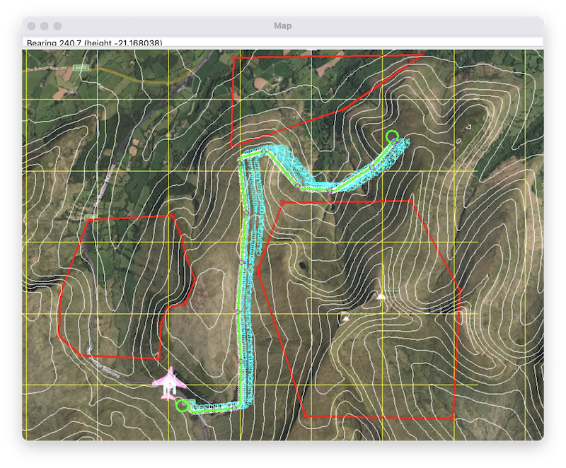

Click Run Planner to solve for a valid path between the start and goal.
If the path clears the terrain it is coloured green, otherwise red. The small magenta circles along the path denote the states that are connected by the Dubins paths. If the planner cannot find a solution the states representing the best approximation are shown, but no path is generated.
The Gen Waypoint button samples the path and creates a series of waypoints that are sent to the vehicle.

Update
One of the benefits of using a Python version of the planner is that extensions to the state validity checker are straightforward: for example adding exclusion polygon fences.
