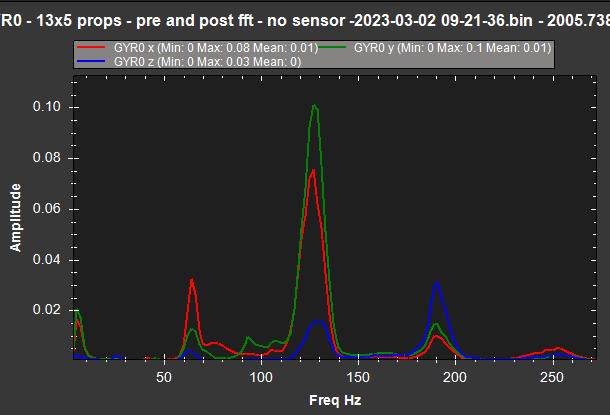

I hear there are improvements in the pipeline for FFT to pick up on the base frequency more reliably when it’s down in the low (sub-80Hz?) range.
See in your FFT settings and data…
It’s getting confused about something, because it’s using the 1st harmonic. You could alter some of the FFT settings, but in my limited experience when that happens it’s difficult or impossible to get it to focus on the base frequency.

You could try that, might help. Dynamic Harmonic option isn’t working well (see the graph above). I don’t really understand why one would use FFT when ESC RPM via a Bdshot target is available. Even serial ESC telemetry would probably work better than FFT. Or Throttle based as the next selection. IMO FFT is only the best choice if you don’t have RPM as a reference due to old hardware. I’m using it on one old quad with Oneshot125 (remember that?) and it’s a toss up with throttle based as to what works better.

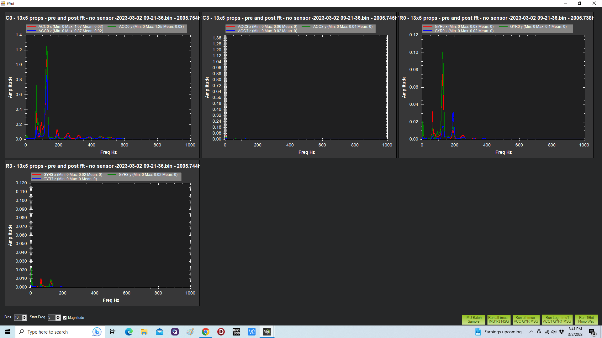

I’m not sure we’re looking at the graphs the same way. Here’s the four charts that are presented now that I have pre and post filter data recorded:
As I see these graphs, “ACC0” is a pre filter graph - and “ACC3” is its post filter graph. The ACC3 graphs shows that the FFT attenuation is reducing vibration a whole order of magnitude over what’s displayed in the ACC0 panel.
The “GYR0” AND “GYR3” graphs show similar pre and post attenuation being achieved - the peaks are a whole order of magnitude lower.
I believe in a comment you made above, you said the “ACCx” graphs are “pre” and the “GYRx” graphs are the “post.” That doesn’t seem possible with the charts that are presented.
Also note that I’ve change INS_HNTCH_FREQ, INS_HNTCH_BW and INS_HNTCH_HMCS per the suggestion of Peter’s @Clogz comment above. So I’m including harmonics.

Basically ignore the Acc graphs (although they can be a clarifying reference or confirmation sometimes).
It’s the Gyro graphs you want, Gyro0 is pre-filter and Gyro3 (with your FC) is post-filter.
You can see in the post-filter graph the peaks are still quite noticeable at the default scale, I’d expect them to be much lower, or really flattened off.
The problem with the HNOTCH settings you have is that it’s still working from faulty FFT data that targets that nice clear first harmonic, instead of the base frequency that caused it.

in the pre- and post-filter graphs, they both would show some filtering even without any HNOTCH settings in place. This is most apparent in the Accel graphs. Because of these low pass filters:
INS_ACCEL_FILTER
INS_GYRO_FILTER

In the mean time - my charts so a 10-times reduction in vibration detected - seems to me that this is a significant improvement.

I agree the FFT can be mostly left to it’s own devices. In your case, and I see it a bit with larger props, it doesnt pick up on the correct base frequency. It seems to be when there’s either a mess of noise (totally understandable), or like yours where the amplitude of the base frequency is low compared to the amplitude of the harmonics.
So you can leave it like it is and “it’s doing something” but that’s not my interpretation of how you work :slight_smile:
I would either go with some of the FFT adjustments to see what helps it work down around 60Hz (you can tell from FFT_FREQ_HOVER), or disable it and set the throttle based notch.
I’m sure you’d feel more comfortable knowing that HNOTCH was targeting the correct frequency and not just a harmonic - I know I would.
FYI, while INS_HNTCH_MODE is 4 and INS_HNTCH_OPS is 2 → the value of INS_HNTCH_FREQ doesnt matter since the frequency comes from FFT. So even though 60Hz is the frequency to target, HNOTCH is ignoring that setting and believing FFT.
