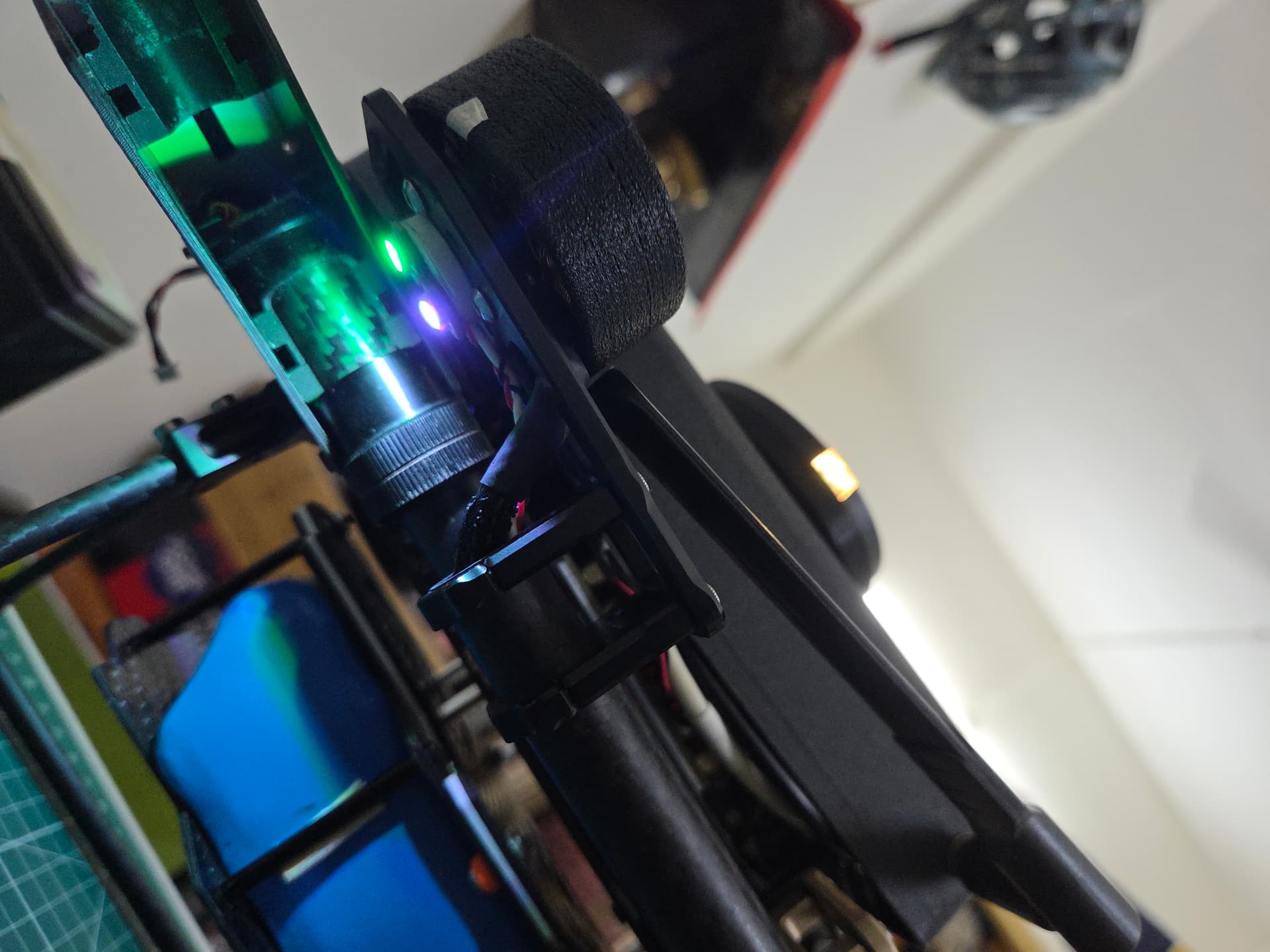

This thing is not working with pixhawk cube orange +. The neopixels are glowing solid with ramdom colours.
