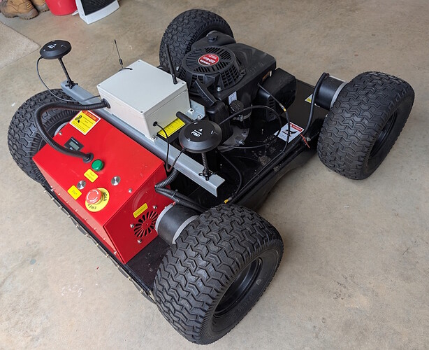

Technically, I think it’s called a brush cutter - the deck is not easily adjustable and fixed. As the landing paddock is basically flat, I decided to take advantage of a different set of bolt holes - I removed each wheel and dropped the deck.
Some changes:
  • Changed the power button to an emergency stop.
  • Added a long range relay as another emergency stop
  • The electric motors stop but not the petrol engine - add a relay to stop that.
  • Add box which contains Pixhawk 6C, Telemetry Radio, RC Receiver
  • F9P GPS (x2)
Hopefully, I’ll get to fire it up later this week.
That is a great looking setup! I have one that I just Purchased that is very similar and I haven’t started modifying it yet.
Looks great! Please post some videos operating when able. Good luck!
