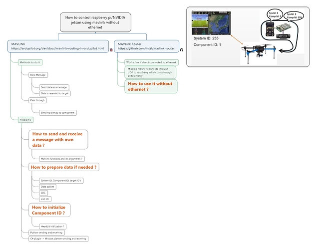

Maybe someone could help me on implementation of mavlink routing.
Main idea to send data to raspberry pi which will be connected through telem2, also send a acknowledge.
I have plugin (C# visual studio) for the mission planner, which works great. Now I want to send through pixhawk data to raspberry pi.
So how to send data using mavlink router ? and how to receive it in rasberry pi ?
I have read this https://ardupilot.org/dev/docs/mavlink-routing-in-ardupilot.html
but it not explained for me, just gived tips what it is possible.
Practically I need some tips on functions in C# and in python for raspberry.
for example msg.send(telem2, data)
Thanks

I explained not so clear. I could get all telemetry using mavlink and mavlink router (I have builded) if raspberry is connected to the network. But I am asking a little bit different for example my system
ground station (Missio planner + plugin C#) -> Telemetry(3dr) <-------> Telemetry(3dr) <- pixhawk <- raspberry pi <-camera
Now I want to send a message to raspberry from my plugin to change a camera mode and want to get from raspberry acknowledge. How to do it without raspberry connection to network ? only using UART between pixhawk and raspberry. On raspberry python script is used. Pixhawk is just a pass through system.
At google I can find only some tips and discussions
Thanks
step by step
I have written 2 python scripts, one at rasp and on on PC. And at monitoring script I can’t see heartbeat of rasp in mavlink data flow :frowning:
However, from rasp I can monitor pixhawk also as from pc, so I have a link.
