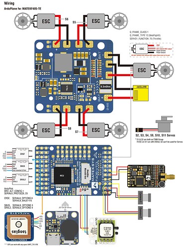

I am new to vtol, so right now trying to properly wire matek f405vtol flight controller. Basically idea is simple - plane (tandem) to take of like a drone and then toggle switch to fly like a plane.
But when I plug the board - nothing happens. I am using sbus to connect to flysky, and servos works as expected, but engines doesnt wanna work. Is there any specific guide on this case? Thank you
Have you gone through all these setup instructions?
https://ardupilot.org/plane/docs/quadplane-setup.html
