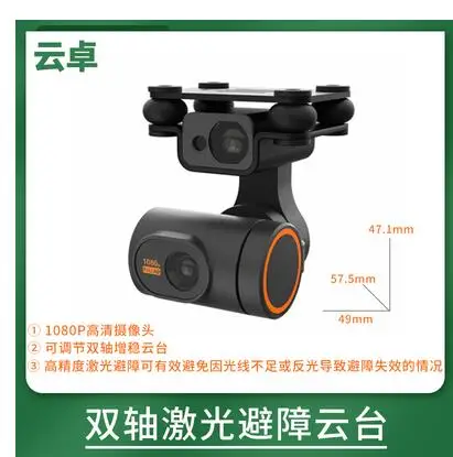

Hi, I have a Skydroid T12 and I recently ordered the new skydroid two axis Gimbal camera.
Everything works great. The gimbal works. I can move the camera using the mini joystick on the transmitter. I get a great image on my phone from the camera. the gimbal is very stable.
But the camera does not record. It came with a 16gb SD card already installed, but the card is always empty. No video is recorded to the card.
How do I start recording?
I have updated the transmitter and receiver to v5.4 firmware. I have tried arming the vehicle and pressing RECORD in the FPV app. But the SD card is always empty.
Thank you!
Is the camera output analog or digital?
digital. there is a gimbal controller in the mount which keeps it level. the camera outputs a proprietary digital stream to the rc receiver. It also has an SD card slot in it, with a card installed.
problem is, the sd card is always empty.
I canā€™t find any instructions for this camera. none. no sign of it on skydroid website.
am I the only person who has bought and installed this camera???

I also use this T12 with 2 axis Gimbal Cameraā€¦ I can record video or photo directly on my mobile phone. So all the recording video and photo is in the mobile phoneā€¦ I knew there is a micro SD card on the Camera, but I have not checked it yetā€¦
T12 gimbal camera is much simple than SIYI MK15 or 30ā€¦ But it has full HD resolution small camera.
@Corrado_Steri , connection is very simple. Just connect directly to the RX . I think This gimbal camera is special made for the T12. I will post a photo laterā€¦
