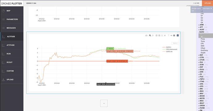

Dronee Plotter is another web-based tool. This one is 3rd party and closed-source, as far as I know. I don’t know much about it, I have to admit.
I also don’t know where my log ends up to when I upload it. I suspect it is processed only locally, but I can’t be sure.
But it does include a Parameter view and a messages view, which are very nice to have.
It comes with some stock plots, but you can’t save any presets.

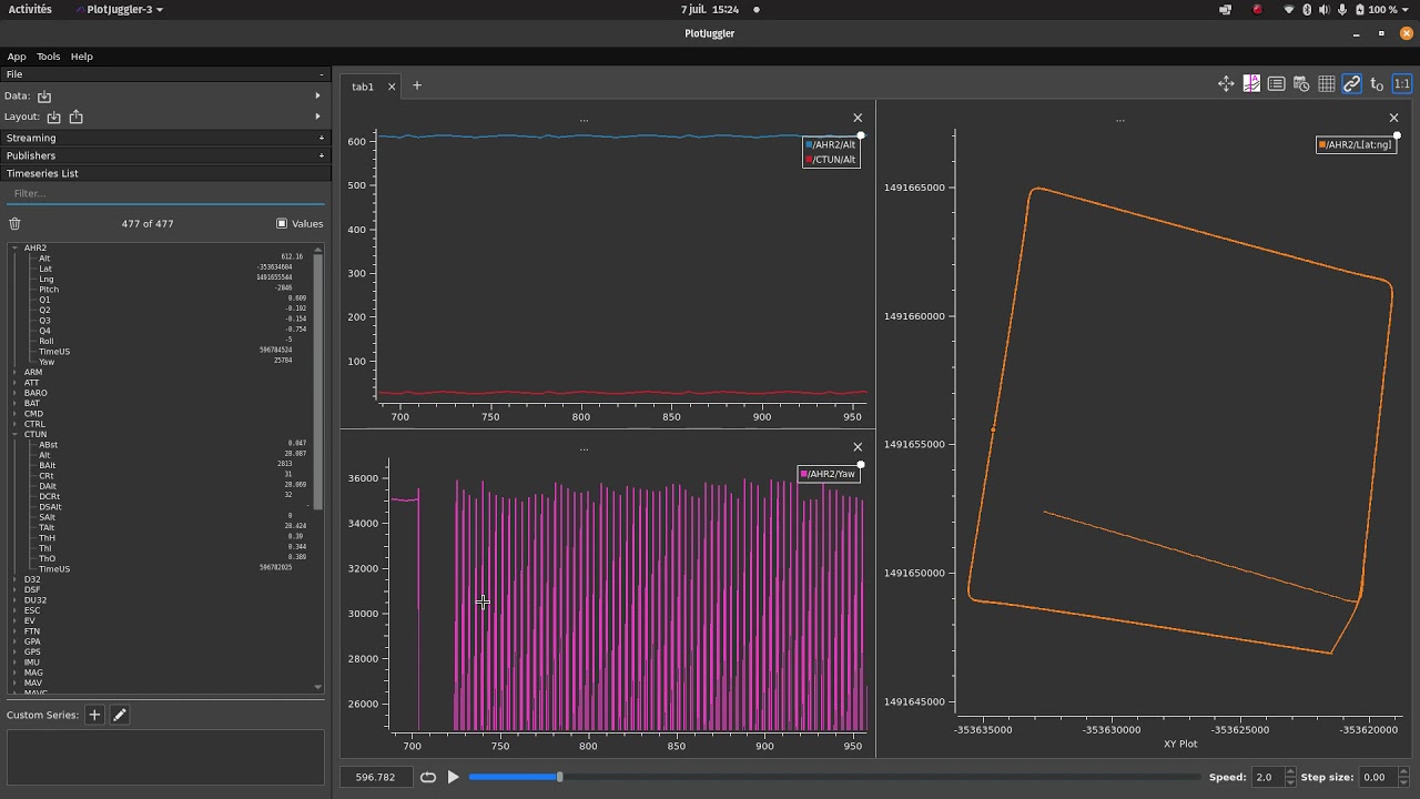

To plot a timeseries, drag it from the left to a grid. Then drag a few more. Then name your plot by double-clicking the ellipses (...)
You want another plot next to it? Split the view as many times as you like.
Not enough screen real estate? You can create a new tab and name that too!
You can zoom in and out and all of the plots will share the same time axis. Just make sure you enable the corresponding option.
Shift+click anywhere on a plot and you will place a time-cursor. And the best part: This time-cursor will be moved to the same time instance in all plots!
Wanna plot two timeseries in X-Y fashion? Select them both and drag them on a grid with the right-mouse button.
:warning: By default you can’t X-Y plot two timeseries from different topics, because they don’t share the same time axis.
But that can be circumvented by resampling a timeseries on the time axis of another.
More on that later.
How about some data manipulation? Open the Apply filter to data context menu and you can choose among derivatives, integrals, scale, offset and more!
