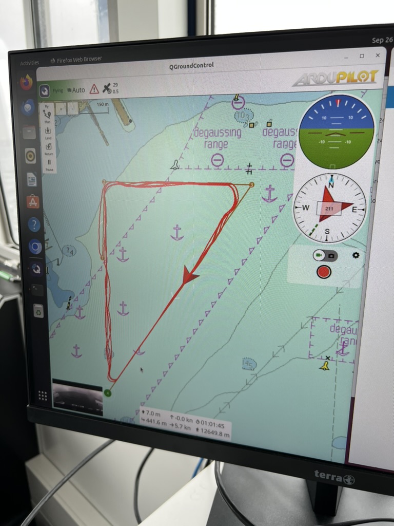

this looks promising. we are getting better slowly running waypoint missions but at the moment due to holiday season having problems finding enough space on the ocean to run waypoint missions without hitting other boats. most of the times we meet sailing boats so we have to stop and let them through. we will chech PSC_POS_P and ATC_STR_RAT_P to match your values and report back.
we wen’t for a ride today and after tuning ATR_STR_RAT_P = 2 yaw in Acro-Mode was steady ±.2 degrees and with PSC_POS_P we were strait on the planned route. now looking into heading-change at waypoint, it seems we are overshooting them. Heading to next waypoint changes after 20-50m of passing the actual waypoint so we start turning way to late instead of infront of a waypoint. Running ArduRover 4.5.4 on a Navio2 with an external Hemisphere GPS.
how is your progress @nido009 ? Am am hoping to build a large arduboat at some point.

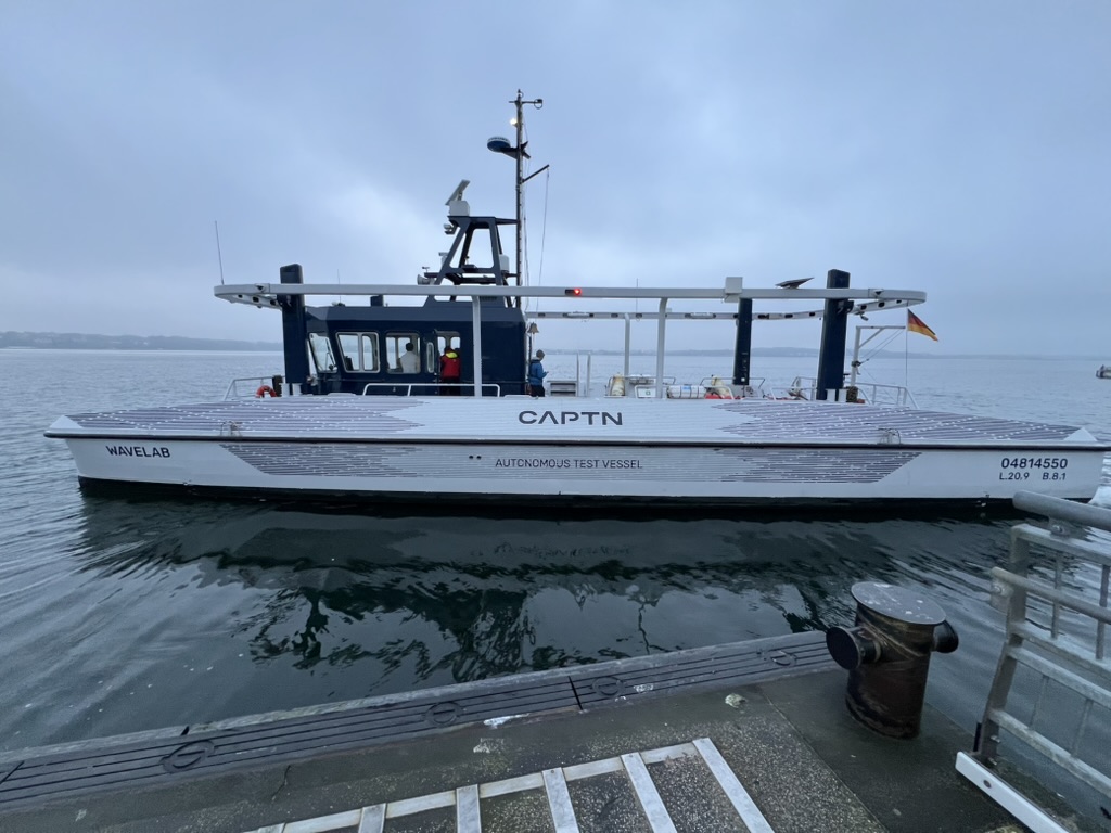

Hi, we moved forward a lot and made the vessel run fine with a couple of caveats. We completed the tuning-process to s-curves worked fine, crosstrack-error was minimal. We pushed it to the limits by trying to run search-pattern (parallel lines with about 25m distance in between).
I have to look into my notes on what parameters made the S-Curves work fine.
We running in auto mode we had the problem that the vessel would turn into corner to fast and then wobble around the upcoming straight till it settled on this. we could not solve this.
we then moved on into guided mode. there this woble after destination change was even worse. wo moved on to guided mode because our goal was to control the vessel from ROS2. We changed the FlightController from Navio2 to Pixhawk6x, results were comparable between these two flight controllers. The we started digging Tinto ArduPilot-Ros2-DDS. We could not make this work reliable to we changed to mavros, which was very stable. we could send speed and turn rate to the vehicle and control it from ros2. Then one of my crazy colleagues sat down 30 minutes on a ship ride and wrote an ros2-node to translate from cmd_vel vectors (speed/turn-rate) to our engines directly with pid-controllers for speed and turn rate and kicked out ardupilot.
we need ros2 for path-planning. our goal is an autonomous vessel that will obey shipping-rules like colreg-aware collision avoidance. In my personal opinion I tell an autounomous surface vehicle where it shall be at the and and it will obey the rules of shipping and get there on it’s own. To do collision avoidance and path-planning we utilize S63 SeaCharts, AIS, Radar (X-Band and mmWave Conti Ars-548) and Lidar (Ouster OS2, Blickfeld Cube).
