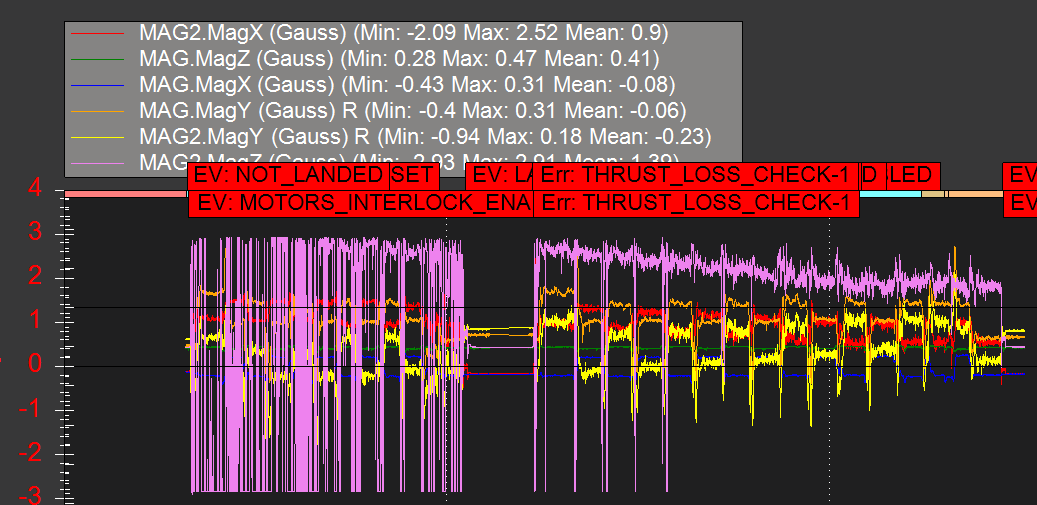

Hey guys.
I have been learning the last couple of months and now started to do some guided flights and things seem to be going well. To me it is flying fairly well, but I noticed doing a auto analysis on today’s 10 min flight I got a fail…large change in mag_field 49% message.
I am flying a spray drone that is a Hexa powered by HobbyWing X8 Pro Motors and ESC’s…the props are 29 inches running on 12s.
Please, if you could take a look at my log and let me know what might be causing this and anything else that needs to be improved or worked on. From what I have been reading my vibration levels seem ok, but I am concerned about clip2 as it keeps going up and I thought I read that might be bad. Anyways, your thoughts are greatly appreciated.

I think this graph from MissionPlanner shows what might cause that auto-analysis mag_field warning:
You can see the Mag2 Z is highly affected by the current draw and the interference drops to nothing at the end of the flight.
You could perform the Compass/Motor calibration - that will be interesting with 29inch props. This will help your Compass issues since there’s a big difference between current draw at the start of the flight and the end. BE SAFE!
https://ardupilot.org/copter/docs/common-compass-setup-advanced.html#common-compass-setup-advanced-compassmot-compensation-for-interference-from-the-power-wires-escs-and-motors
After that observe logs from another flight, or post in here again.
The next step, and the one most people just do as a matter of course, is disable the onboard compass:
COMPASS_USE2,0 or COMPASS_USE3,0 - disable whichever gives the most erratic readings.
Wow, thank you so much for your reply…I have learned a bunch from it.

Also, I understand at full load as I was today my power current goes way up and looks like that causes some issues. Yes, I am trying to protect battery life…using a Mauch sensor. I will look into disabling the onboard compass. I am stressed out of all this…lol. It is just the two of us and has been a lot of work and learning. Still wish I could understand logs better. Again, thank you!

How do I disable the internal compass? Uncheck compass 2 and 3? Maybe it is obvious and I am just missing it. Thank you.
The esc’s are that I am using use a pwm signal of 1100 thru 1940.
Usually an external compass gets labelled as Compass 1, so 2 and 3 are internal. In that Compass calibration screen you can just untick the ones you dont want to use.
It’s safe to disable the internal compass(es) and quite common.
