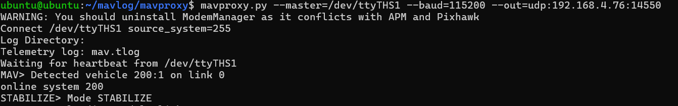

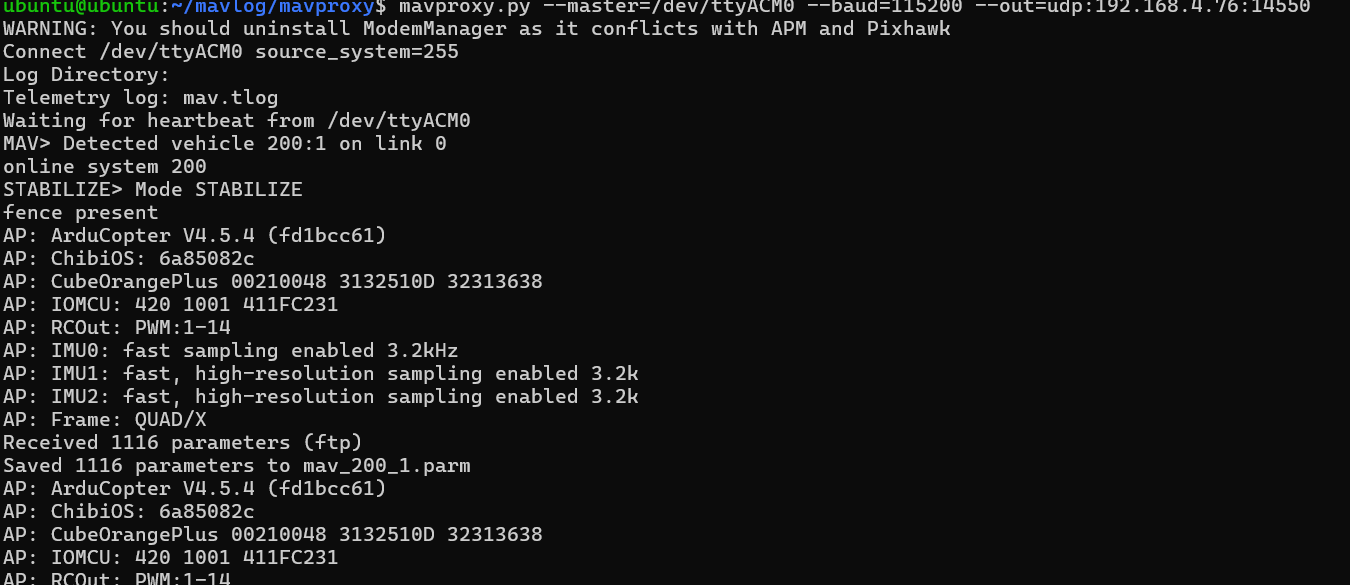

I’d like to share my experience.
I’m connecting a Jetson Nano (via /dev/ttyTHS1, GPIO UART1) to a Cube Orange+ (via TELEM1/TELEM2).
The connection partially works — the Jetson receives some heartbeat messages, but other MAVLink messages such as version information are missing.
In addition, the vehicle does not accept mode changes. I tested this using both MAVProxy and DroneKit-Python.
When connected via USB (via /dev/ttyACM0, Jetson Nano USB ↔ Cube Orange+ USB), everything works perfectly — all messages including version info are received, and control commands are accepted.
In the case of DroneKit-Python, I needed to set the Serial5 protocol to “None” for the connection to work properly.
I’m planning to test with an FTDI adapter soon.
Any advice or known limitations about using Jetson’s GPIO UART with Cube Orange+ would be greatly appreciated.
I’m not sure if it’s due to timing or if a full serial connection (RTS/CTS) is required.
If possible, I’d prefer to avoid using RTS/CTS.
I’ve connected the Pixhawk1 and Pixhawk6C in the same way without any issues,
so this seems to be a problem specific to the Cube Orange+.
For reference, when using an FTDI cable, everything worked perfectly without RTS/CTS.
