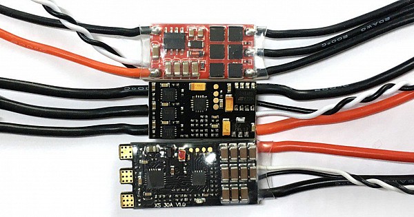

and here are some images of the motors and esc’s and didn’t find anything about them ont the internet that’s why i calimed they are “nameless” maybe you or someone used them can help.
the motors are a2212 but i couldn’t find anything on the esc’s

You need to troubleshoot with Motor Test. Testing using the Transmitter tells you nothing. You have a real mess of wiring there. Check all your solder joints and perhaps replace the ESC on the non-running motor. With those junk ESC’s you should buy 6 to get 4 working.
Remove those props! Yikes.
As Dave said you must check with motor test, and you need to check each motor rpm at the same % output from the motor test page.
yeah i knew those esc’s aren’t great i’ll try to get better quality ones,and aside from esc’s should i be looking for anything else ?
