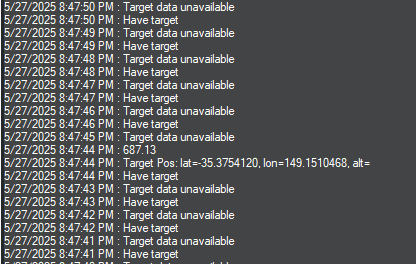

However, I am getting the following error:
3/12/2025 5:53:35 PM : Internal Error: ./scripts/servo.lua:134: attempt to index a nil value (global 'follow')
How do I properly initialize the follow object for the rover to follow the flying copter? Or Is there a specific setup or configuration required to enable the follow functionality in ArduPilot Lua scripting?

For a reason unknown to me, the devs have chosen to limit the follow binding to Copter or Plane.
@rmackay9 could perhaps elaborate on the rationale.
I don’t think it’d be problematic to simply enable the binding for Rover, but you’d need to set up a build environment and make the change yourself unless Randy or another dev see fit to enable the follow binding for Rover.
See here for the source:
@Yuri_Rage Thanks for your response! I’d love to hear from other developers about why the ‘follow’ feature isn’t supported for Rover in Lua scripts, or if there’s a way to modify it to make it work more easily.
Thanks @Yuri_Rage for the investigation.
I don’t think that there’s any reason why we can’t enable this for Rover so I think it’s just a small change to add Rover to that list of available vehicles.
I could raise a PR to change that or anyone else could as well I think

@PMTAug,
I’ve created a PR that enables the Follow bindings for Rovers and Boats.
If you’d like a firmware to test with please tell me which autopilot you’re using.

Hello @rmackay9,
Thank you so much for your work! I’m currently using firmware version 4.5.7.
The reason I didn’t use Rover’s Follow mode is that I want the rover to move to a point calculated by optimizing the positions of several copters. To achieve this, I use a Lua script for control. Following a flying copter is simply a test case to validate the Lua script.
