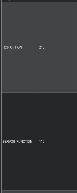

Hello, I have Arduplane 4.1.7, I use it on plane with airbrakes. I use Channel option 210 (airbrakes) - of course RCx_Option=210, Servon_Function=110
Airbrakes works as expected, I can control them via channel, but any time I change the value of the channel I receive error message"INF: Invalid channel option(210)"
Both in Mission planner, but what is most annoying also when using frsky telemetry and Yaapu script…
I believe, that Channel option 210 (airbrakes) in not fully implemented in code.

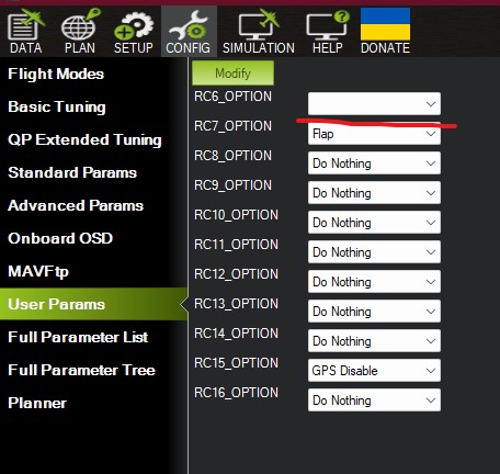

Hi, I have seme issue
opened 02:19PM - 16 Aug 22 UTC
[Airbrakes](https://ardupilot.org/plane/docs/airbrakes-on-plane.html) - Describe… the issue/suggestion and improve the title. Please keep a link to the original article if relevant.
Hello. I want to setup airbrakes.
I am doing everything like here: https://ardupilot.org/plane/docs/airbrakes-on-plane.html
![001](https://user-images.githubusercontent.com/24563723/184902059-a67c979d-885a-4e23-91f7-5c2b15547ecb.jpg)
But in other windows there is something strange:
![002](https://user-images.githubusercontent.com/24563723/184902267-cd2e1efc-a61f-4389-b398-3a23e71a247d.jpg)
![003](https://user-images.githubusercontent.com/24563723/184902289-aff2d3bd-3a74-4e35-8b9d-41ce6f5354fb.jpg)
And I have an error:
![004](https://user-images.githubusercontent.com/24563723/184902438-4e8275c1-4b37-4924-83d3-b112183b1f43.jpg)
Are airbrakes removed from code?
And I want to setup airbrakes for autolanding, but they working only on manual input.
