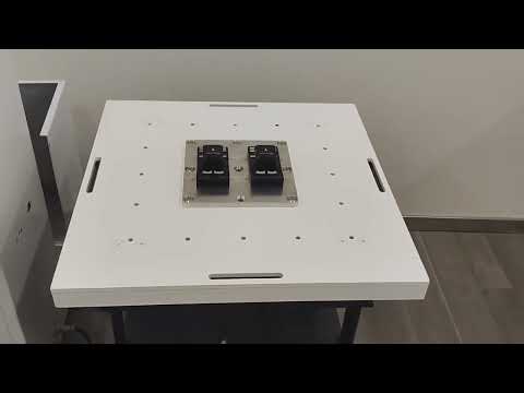

So how do we go about testing the different options? We obviously can do flight tests, but this is not a very rigorous way of comparing different options as factors like weather can produce different outcomes. Some of you may have seen my video of testing resonant frequencies using a vibration speaker:
there is a more “industrial” way of doing these tests - and that is to use a vibration table. Holybro acquired one of these and did much of the flight controller testing for this analysis:
A vibration table can be used to apply vibration in specific directions at specific amplitude. More sophisticated tables can also be used to apply rotational movement to excite the gyros. A vibration speaker, in contrast, can only really effectively apply vibration in a single (Z) axis.
So how are we going to test this? In reality it’s quite simple - we attach the flight controller to the vibration table and apply a range of frequencies on all axes - commonly known as a sine sweep. Typically we want to cover the range of frequencies that is relevant to the IMU, so for example from 10Hz to 500Hz might be quite representative. In order to see the effect we need to switch on disarmed logging, log the gyros at full rate, enable batch logging and enable the on-board FFT so that we can use that to analyse the instantaneous noise. The appropriate parameters are these:
FFT_ENABLE 	1
FFT_MINHZ  	5
FFT_MAXHZ  	495
FFT_SNR_REF 	10
FFT_WINDOW_OLAP	0.75000000
FFT_WINDOW_SIZE	256
INS_GYRO_FILTER 0
LOG_DISARMED	1
LOG_BITMASK	2273278
INS_LOG_BAT_MASK 7
INS_LOG_BAT_OPT 1
Note that we are switching off the gyro filter so that we can see the noise without additional filtering (remember we are only concerned about the effectiveness of the physical filtering at this time).

Pixhawk 6X Pro Vibration analysis
With all these tools in our kitbag we can effectively test different physical filtering options for the Pixhawk 6X Pro. The options at our disposal are a range of weights XXXXX and a range of different types of silicon. We can run our tests against this range and assess whether there is a “best option”. In order to simplify this process for the purposes of this discussion we will simplify this to considering the lightest and heaviest weights.
Here are the representative graphs for 4.3g weight:
Here are the representative graphs for 24.5g weight:
So our general conclusion is perhaps one we might expect - the use of heavier weights has a similar effect to softer silicone and results in more aggressive filtering that pushes the resonance down to lower frequencies. It also results in noise profiles that are more spread out and therefore more difficult to filter effectively. Conversely lighter weights have a broadly similar effect to more rigid silicone - it results in less aggressive filtering, but also resonances at higher frequencies that is less broad and therefore significantly easier to filter in software. The clipping and vibration seems to be largely unaffected, although some benefit is seen from heavier weights. Thus in the context of a “Pro” flight controller it is more appropriate to use lighter weights and stiffer silicone.
