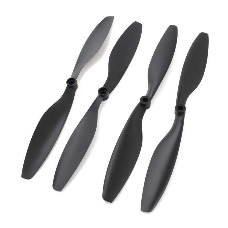

Listen, since in my previous drone, I used plastic 10 X 4.5 propellers, due to the centrifugal force, they broke while spinning and drone crashed from 10m height! This happened many times…
And so this time I am using carbon fibre, but still afraid that what if I fly my drone upto 120m and at that height, carbon fibre also broke! Is my drone safe when I use carbon fibre props? Because motor RPM can go upto 10000 and the drone’s weight will also be 1100gm, so will carbon fibre be so strong that it will handle such conditions at 100s of metre height?!
Good quality carbon props only break when they hit hard objects.
And good quality plastic propellers that have been properly installed don’t break from centrifugal force. If a plastic propeller breaks in flight it is either previously damaged, over torqued, or thread locking adhesive (loctite) has been used.
But I was using newly purchased plastic propellers on 1000KV A2212 13T motors!? Might be the motors were not balanced and due to excessive vibrations the props broke?

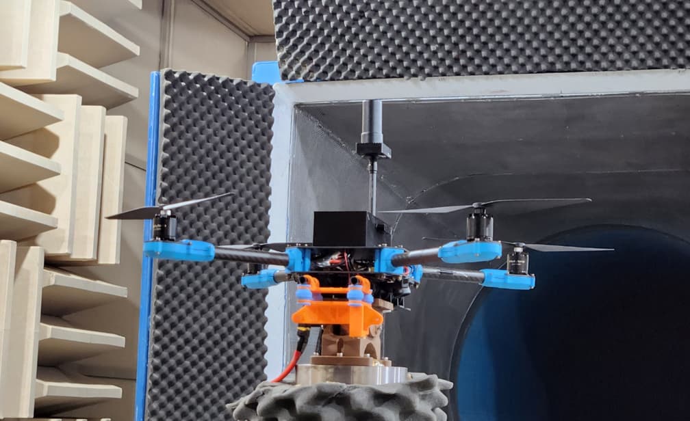

Over the past two years, I have operated more than five Holybro X500v2 drones, and I have never experienced a propeller breaking due to aerodynamic loads during flight.
(Photo from the experiment)
The propellers did not fail even in a wind tunnel, where they were subjected to higher aerodynamic loads than in regular flight.
However, the traditional F450-style propeller, broke under less than half the load in the wind tunnel, nearly causing millions of dollars in damage. I also tried using carbon propellers with the same design as the one in the photo, but they tended to produce even more vibration than the plastic ones. In my opinion, purchasing components with balanced performance and price, rather than opting for the cheapest parts, will help avoid additional expenses and ultimately be more cost-effective.

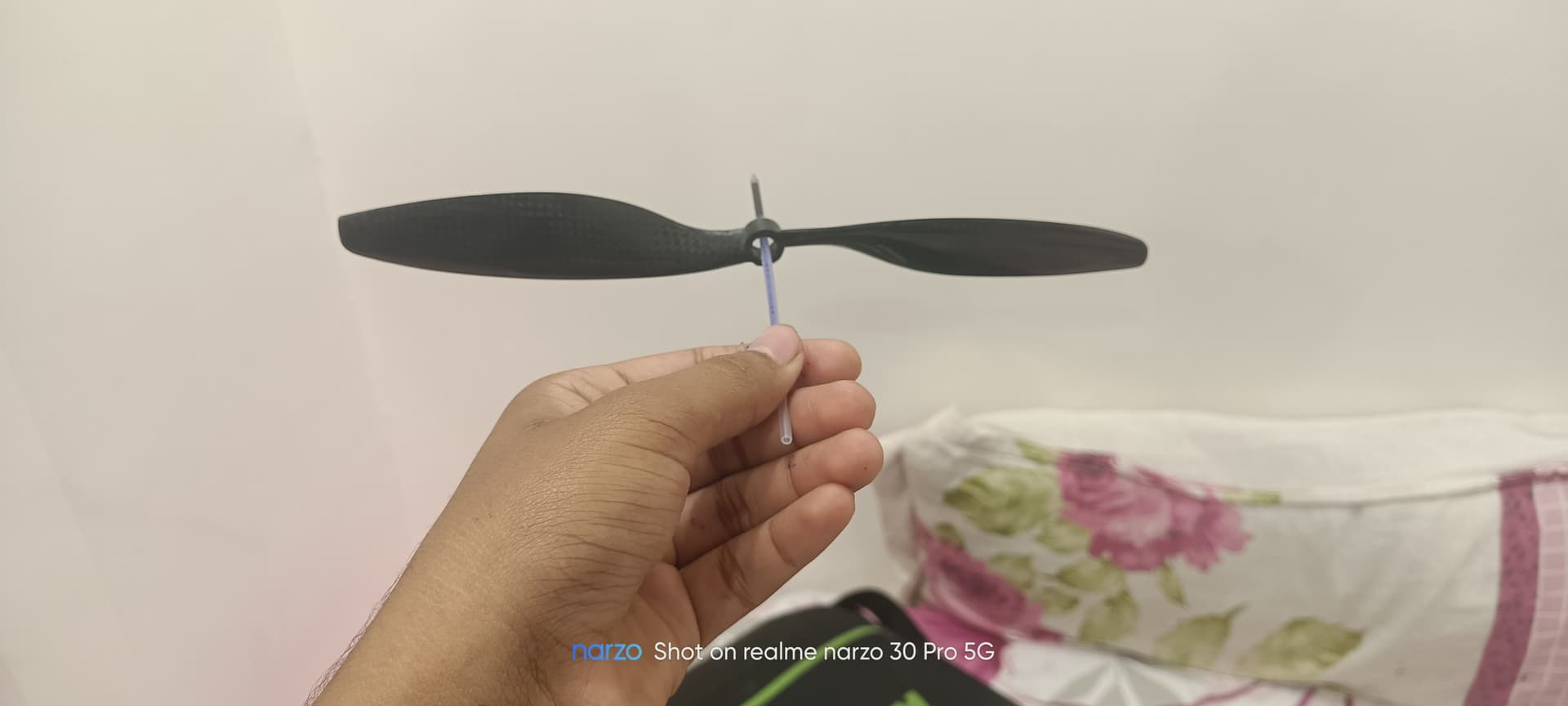

I also checked whether they are balanced, on a thin iron rod, and all the 3 pairs which I purchased, are totally balanced. So I don’t think they will cause vibrations. One of my friends also used them in his drone once, when I touched his drone while flying, it had very less vibrations, only minimal vibrations of motors. His props were also balanced…
Actually I was not measuring the strength, but I was checking whether it is real carbon fibre or not!? These propellers will absolutely not have any cracks as I tried bending them, but these are really stone hard… Not at all flexible like plastic ones …
The issue with DJI-style 1045 propellers is that the root area is too thin, making it difficult for low-quality plastic(most copy manufactures) to withstand repeated loads. Carbon propellers with the same design are free from this issue(assuming the CFRP propeller is well manufactured), so there’s no need to worry about the propellers breaking in flight.
Separately, the issue of vibration is a different matter. Due to the unique elasticity of CFRP, sharp vibrations can occur during high-speed forward flight when there is a lift imbalance in the blades. However, this problem doesn’t seem to require immediate attention. If the motor and propellers are balanced both statically and dynamically, it should not significantly affect normal flight.

See this:::
Similarly are my other 5 Propellers…
Ok they are?
My nearly empty pen’s refill and an old knife is just a less than 1$ propeller balance :rofl:
(Desi jugaad!)
(Indigenous cheap make do!)

Your not balancing the prop this way as your swivel point is out of the center

Who knows. As @Turf1975 said that will tell you nothing. Buy one of these, they are cheap and work well enough.
Ok, let my swivel point be out of the centre, but if the propeller was to be unbalanced, don’t you think that one blade will be continuously going downwards and the other upwards? But all of these propellers remain in this exact position of equilibrium. So, don’t you think they are already balanced if they are not showing any inclination in this setup ?
I don’t understand, why do we need a whole such thing for propeller balance? Why cant we just check that on thin iron rod kept horizontal? If propellers will be unbalanced, they will automatically incline?
