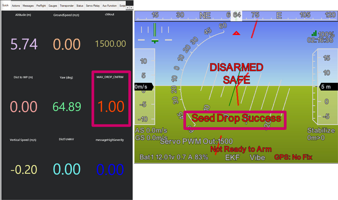

I am implementing a seed-dropping drone. Servo commands trigger a seed to drop, and will hit a limit switch on the way down.
This switch is implemented with button setup, and a LUA script is used to detect a momentary trigger of the switch to send GCS messages and quick panel data.
I have got GCS messages to display and quick panel data to change from 0 to 1 upon detection of a seed dropping. However, as it is only momentary, I want the GCS messages and quick panel data to last longer.
The following is the LUA script i am currently using:

I am running on the Pixhawk 6C ArduCopter 4.5.2.
Any help would be much appreciated, thank you!
