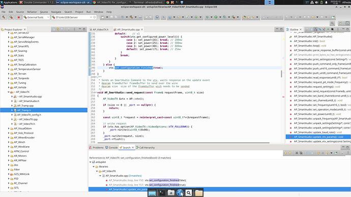

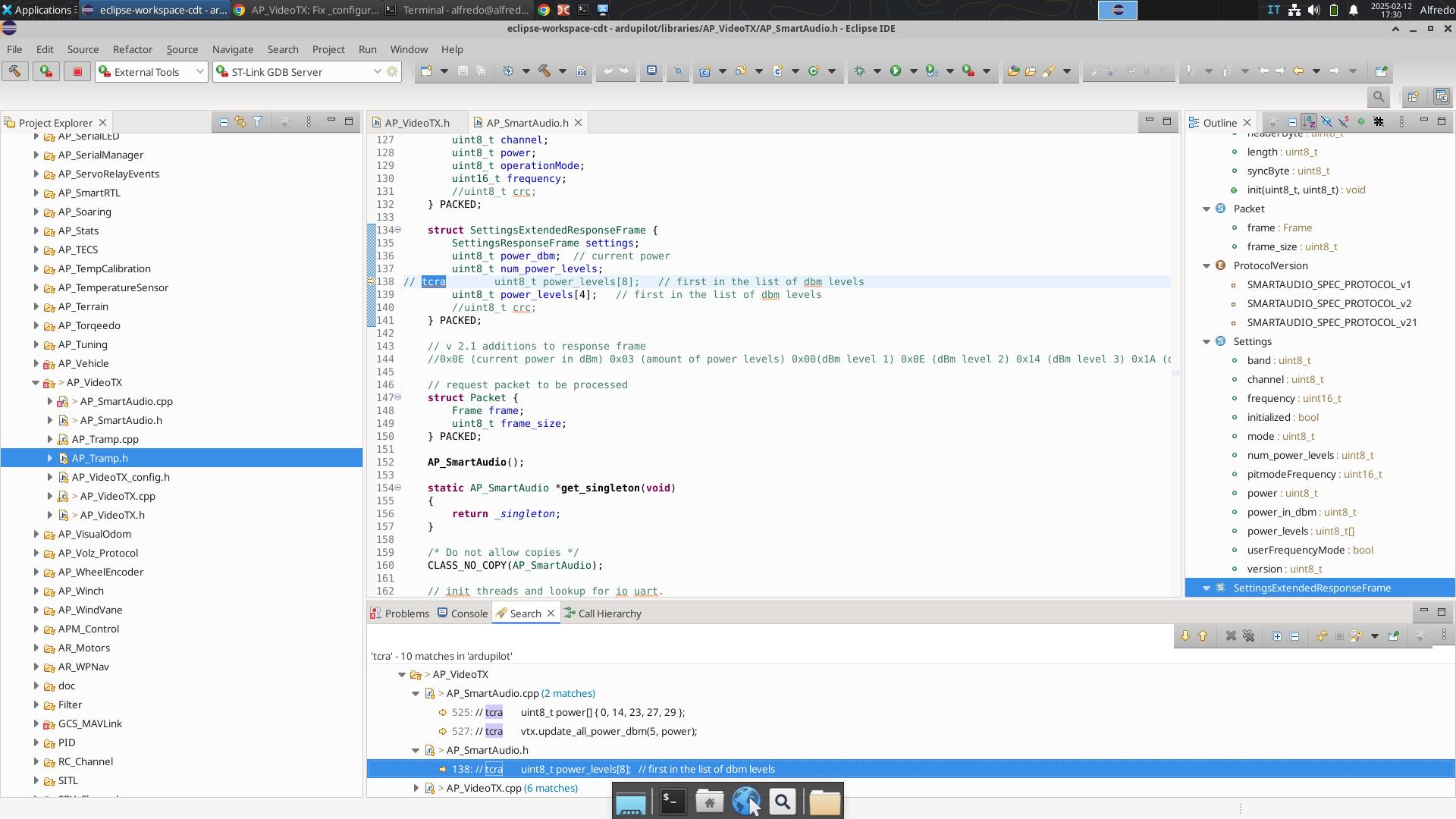

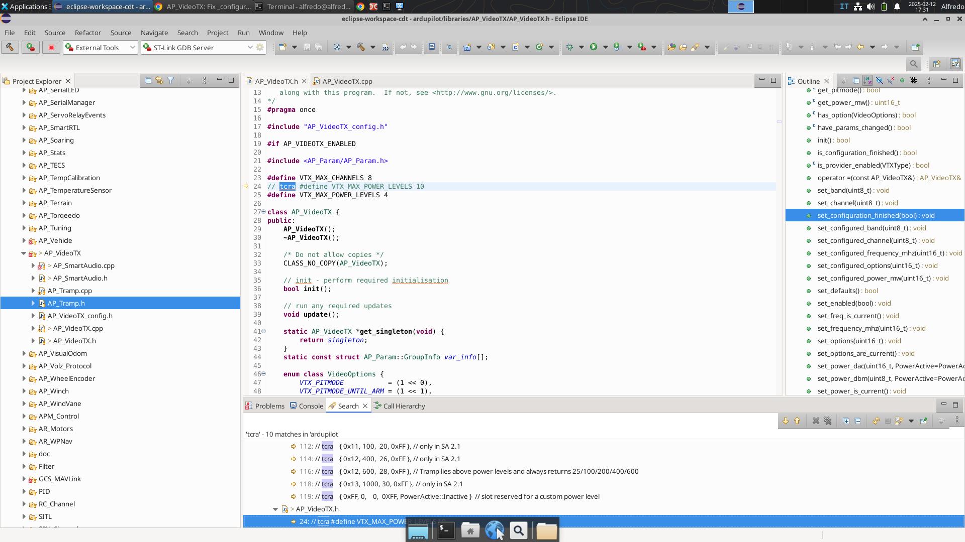

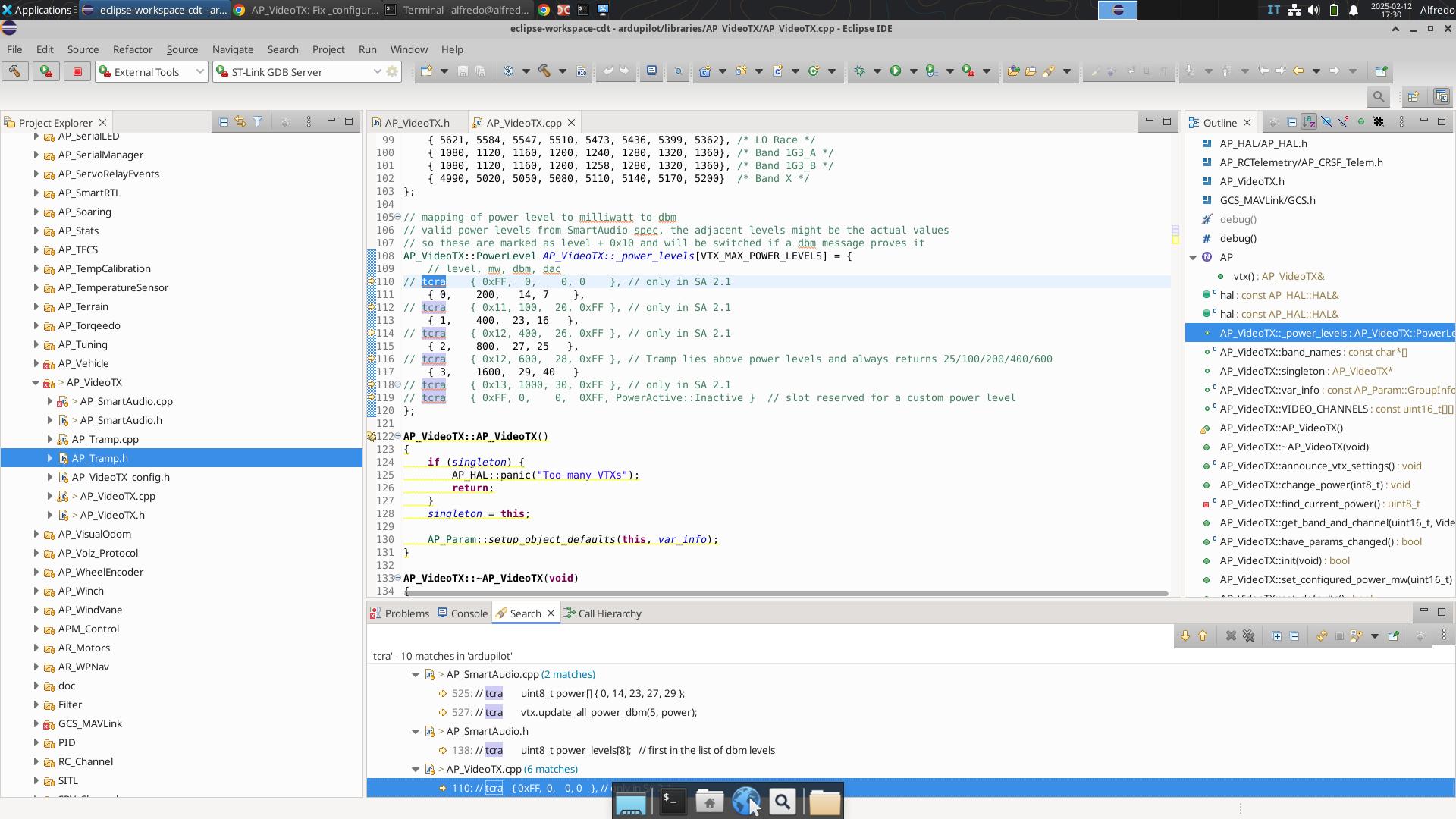

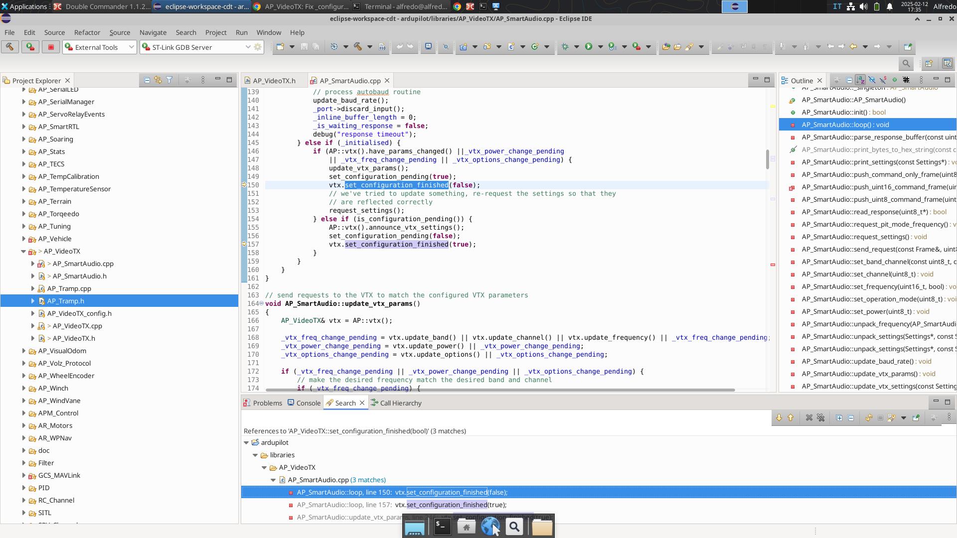

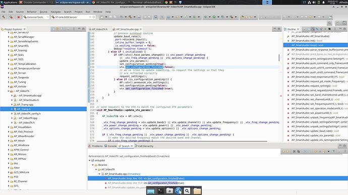

@andyp1per :

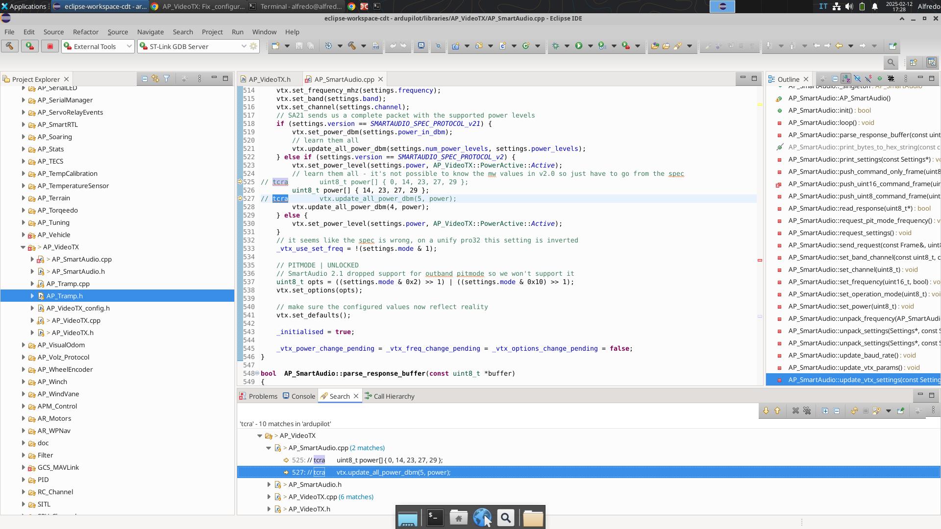

With reference to arducopter 4.5.7, I compiled a custom vtx code that in SmartAudio uses 200, 400, 800, 1600 mw for Akk Race Ranger (old version, new advertized version starts from 25mw).
I found somewhere (dont remember exactly where on internet) that Akk Race Ranger uses smartaudio 2.0, so I searched for smartaudio 2.0 code in arducopter sources.
Why do I speak about Smartaudio here ?
→ because (read following notes …) I think it is pertinent to this discussion about not-compliant devices and because I got a problem similar to the one related to recent merge / discussion (AP_VideoTX: Fix _configuration_finished indication for Tramp VTX by menschel · Pull Request #28584 · ArduPilot/ardupilot · GitHub) in Smartaudio code .
In other words, to put Akk Race Ranger to work in Arducopter, I had to “bypass” protocol responses or queries.
I practised “big-bang” programming and IT WORKS !!! (see following code here).
But …
on OSD, now vtx milliwatt power display blinks all the time.
This is why I refer recent merge (AP_VideoTX: Fix _configuration_finished indication for Tramp VTX by menschel · Pull Request #28584 · ArduPilot/ardupilot · GitHub).
Do You think that vtx power blinking in OSD might be related to my modif (it is not not based on protocol responses …) or does exist some preexisting code problem in handling delays ? I see some delay device-depend code there in the sources…, that sound like last moment adjustements for putting to work some non standard vtx.
I attach here
4 images with the custom changes
2 images where the osd vtx power blinking problem much probably resides.
Thanks in advance if You have a look …
Alfredo
