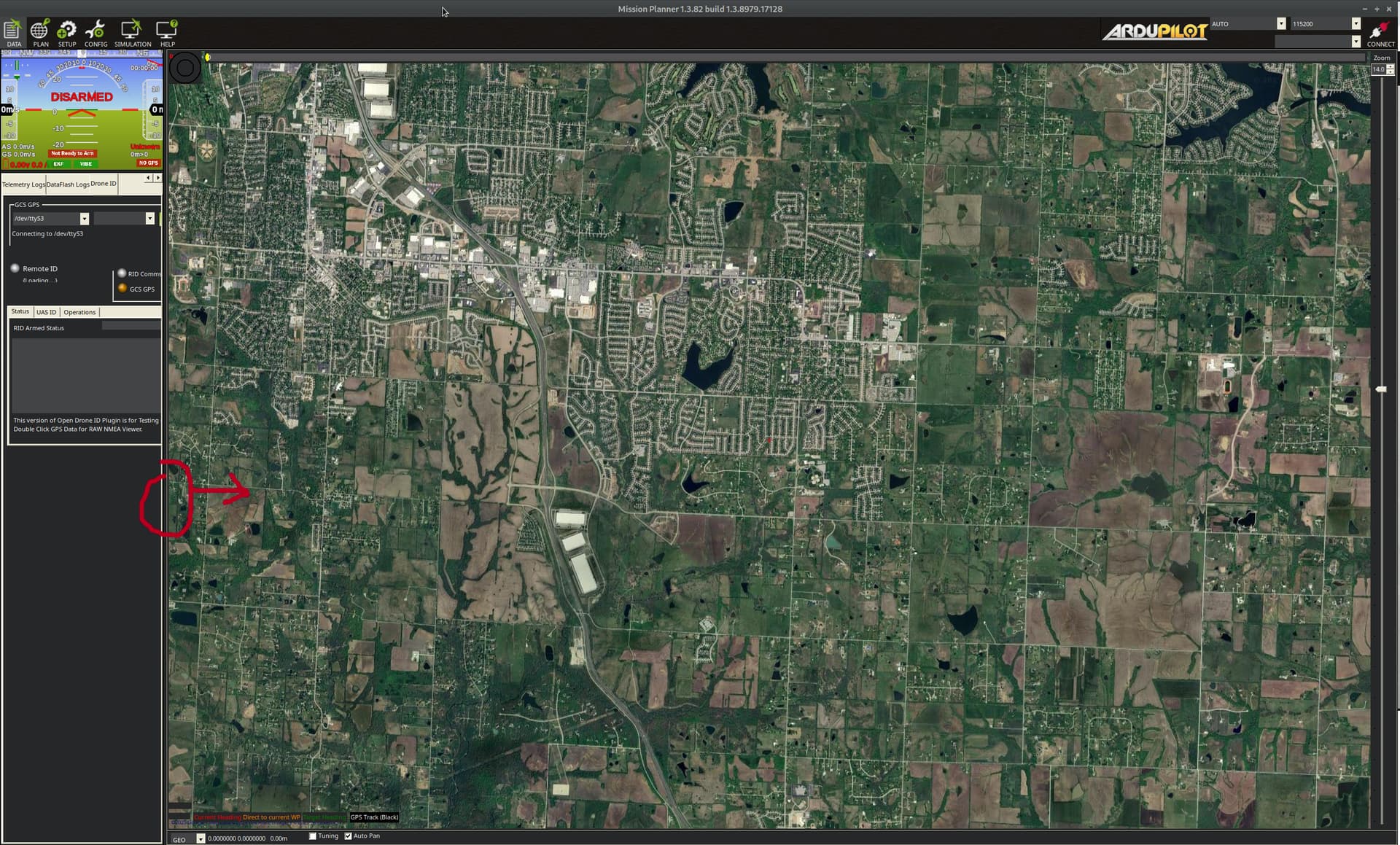

How can I resize the left-hand pane from the position it starts at more to the right? I was expecting a hover arrow to allow me to move it, but when I hover my mouse over the seam the mouse icon doesn’t change.
This is what I’ve got running MissionPlanner(circle and arrow showing what I’d like to move):

Dragging the divider should work.
What OS ?
It does work on Windows, not sure about others.
Anyway you can change the divider position in the config.xml file by setting the
<FlightSplitter>583</FlightSplitter>
value
Linux/Mono.
Thank you for that XML.
sometimes changing the map and the hud position (swap map and hud, right click on map) will let you move certain things around.

You are correct, it did work on Windows.
I switched my bootloader config around so that I can boot Windows and then boot my Linux disk in virtualBox to build, and now I can build and resize my mission planner.
