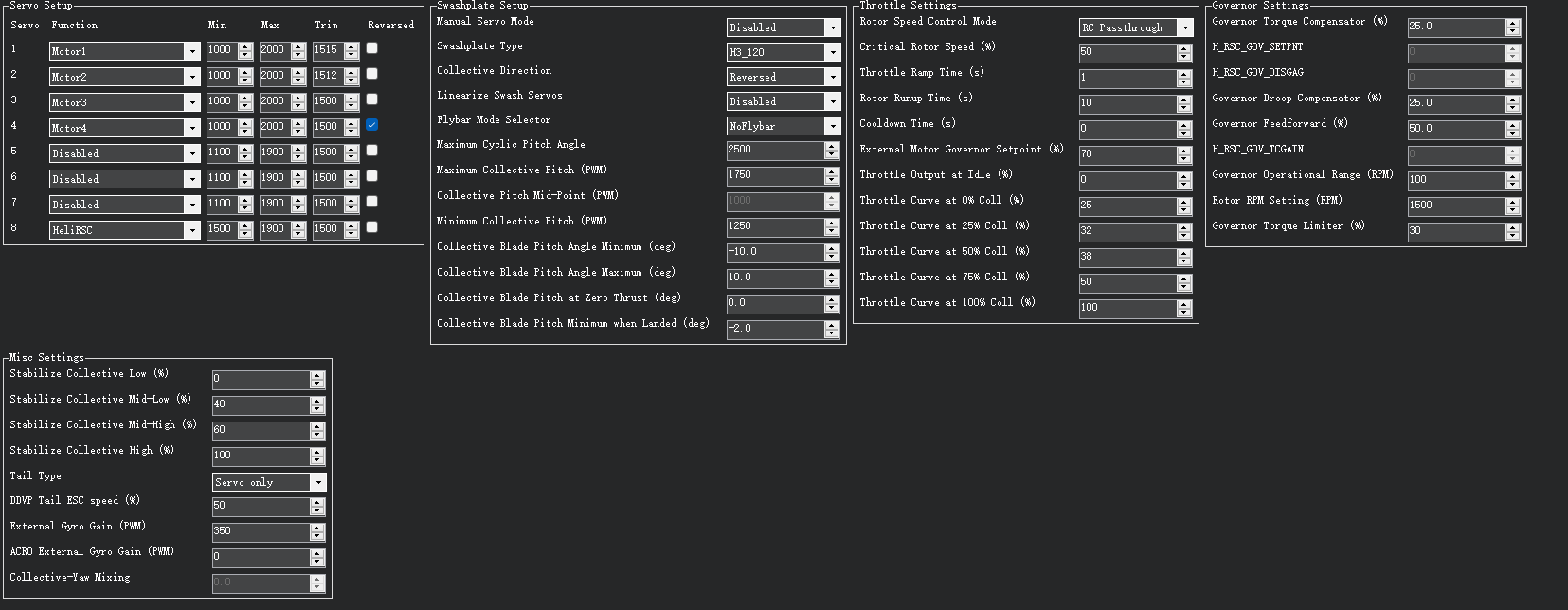

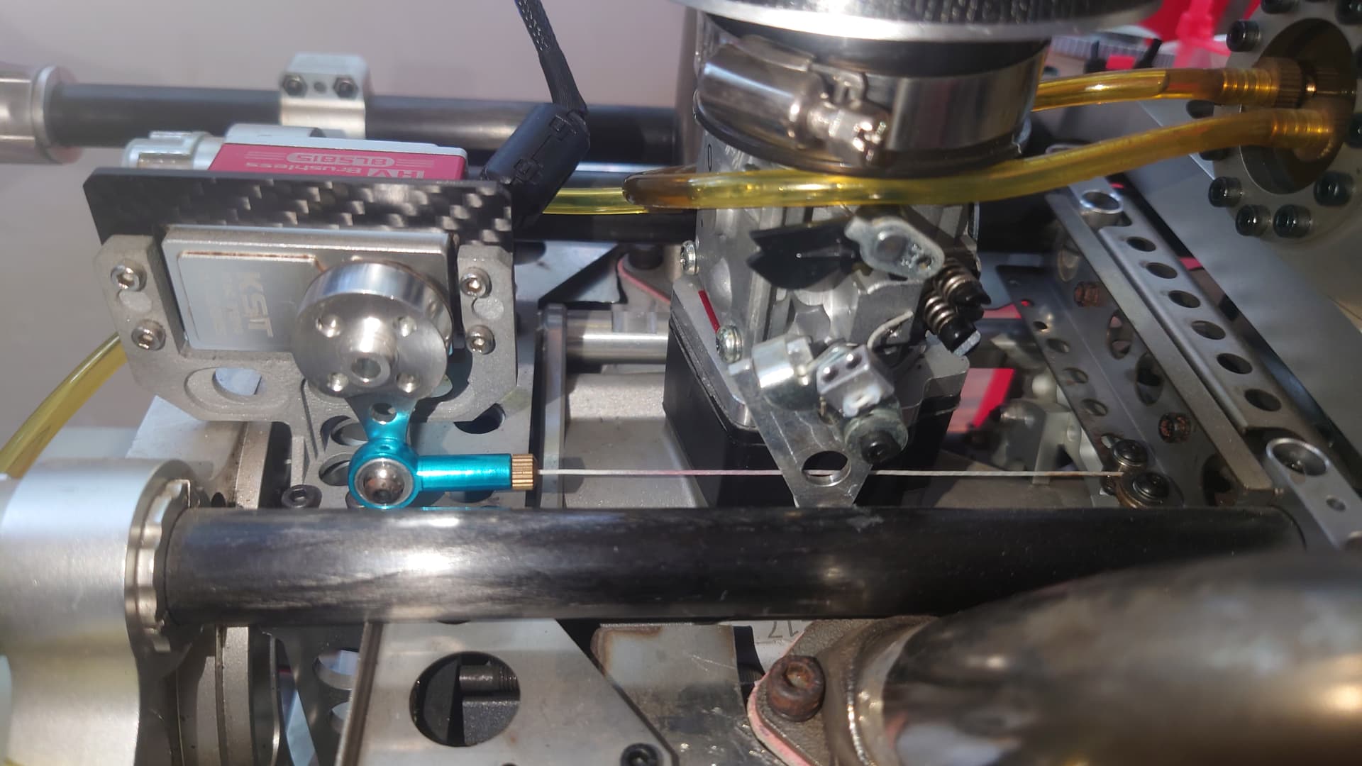

hello guys,i am buliding a gasoline engine heil。I set up SERVO8_Function a value of 31 ,MOTO INTERLOCK with RC8,
I can`t control the throttle of engine with my rc joystick when i disarm moto interlock and disarm my heil?
i don’t undestand what happen and how to fix it,tell me and save me PLZ!

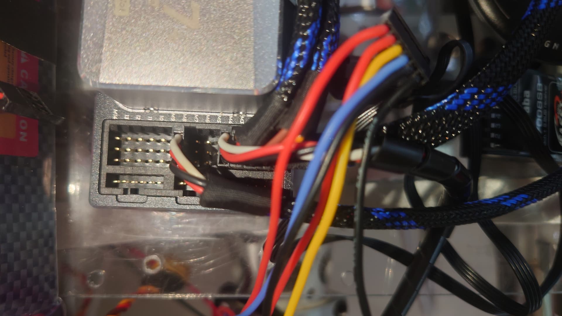

I use Cuav X7+PRO

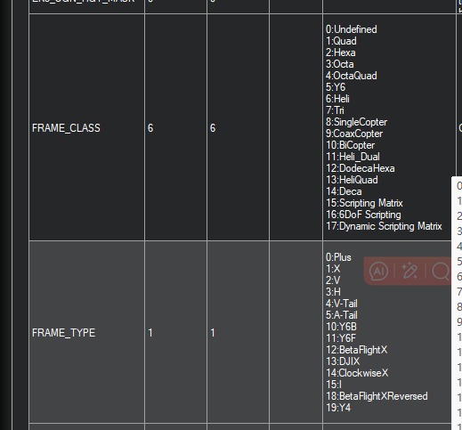

is it because i didnt chgoose the right frame?

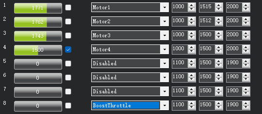

And I found that my 8th channel has no output, is it related to this?
It is definitely due to servo 8 being assigned boost throttle. That should be assigned HeliRSC. Looking at your previous post showing the Heli set up page, servo eight was assigned correctly. Not sure how it got assigned to the boost throttle function. Did you change anything?
i change sevro8 to HeilRSC,but noting different
At first, I did set it to heilrsc, and after finding that there is no effect, set it to Bosstthrottle to see if there is any effect.
