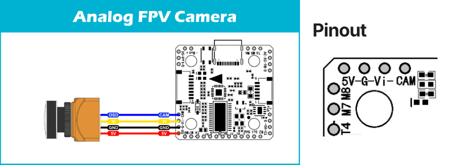

I have a Hawkeye 4K Thumb camera attached to a Holybro Kakute H7 mini v1.3 FC as this:
The board is documented here, being CAM documented as:
CAM: to camera OSD control
The hwdef.dat of this board is here, which includes this other which describes most of the signals (except CAM) and components:
https://github.com/ArduPilot/ardupilot/tree/master/libraries/AP_HAL_ChibiOS/hwdef/KakuteH7Mini/hwdef.dat.
I only want to do a very simple thing (not camera OSD control): have CAM signal normally high, and set it low with a momentary switch at the transmitter (using CH10), to start/stop video recording. If trying this to activate the buzzer (documented above at pin 80):

but CAM signal seems ignored, or I cannot find its definition. What can I do to use CAM signal?
