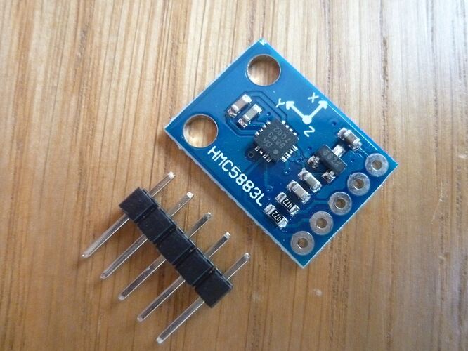

I was wondering if anybody had any issues with the HMC5883L not working with any of the orientations provided (due to it reporting left-handed results). I’m not sure if this is an issue at all with the HMC5883L or if it’s just the chips I got.
I’m trying out the HMC5883L on my autopilot and I have been unable to calibrate it. Trying different orientations results in either one axis flipped or all three axes flipped. This is a similar issue almost a year to the date from my last mag issue with a left-handed coordinate system MMC3416 One Axis Reversed (I fixed that with a driver change in a local ardupilot branch).

This tells me either 1 or 3 axes are flipped negative, or maybe 2 registers are being read in the wrong order (e.g. x and y are swapped). Regardless, I am getting left-handed results and I am not sure why. I wanted to post here in case anybody else experiences this.
did you ever get to the bottom of this, I have been trying to get to calibrate a couple of these and have just got garbage results. I wonder if these are fake or something like that as they were very cheap.
GY-273 HMC5883L
