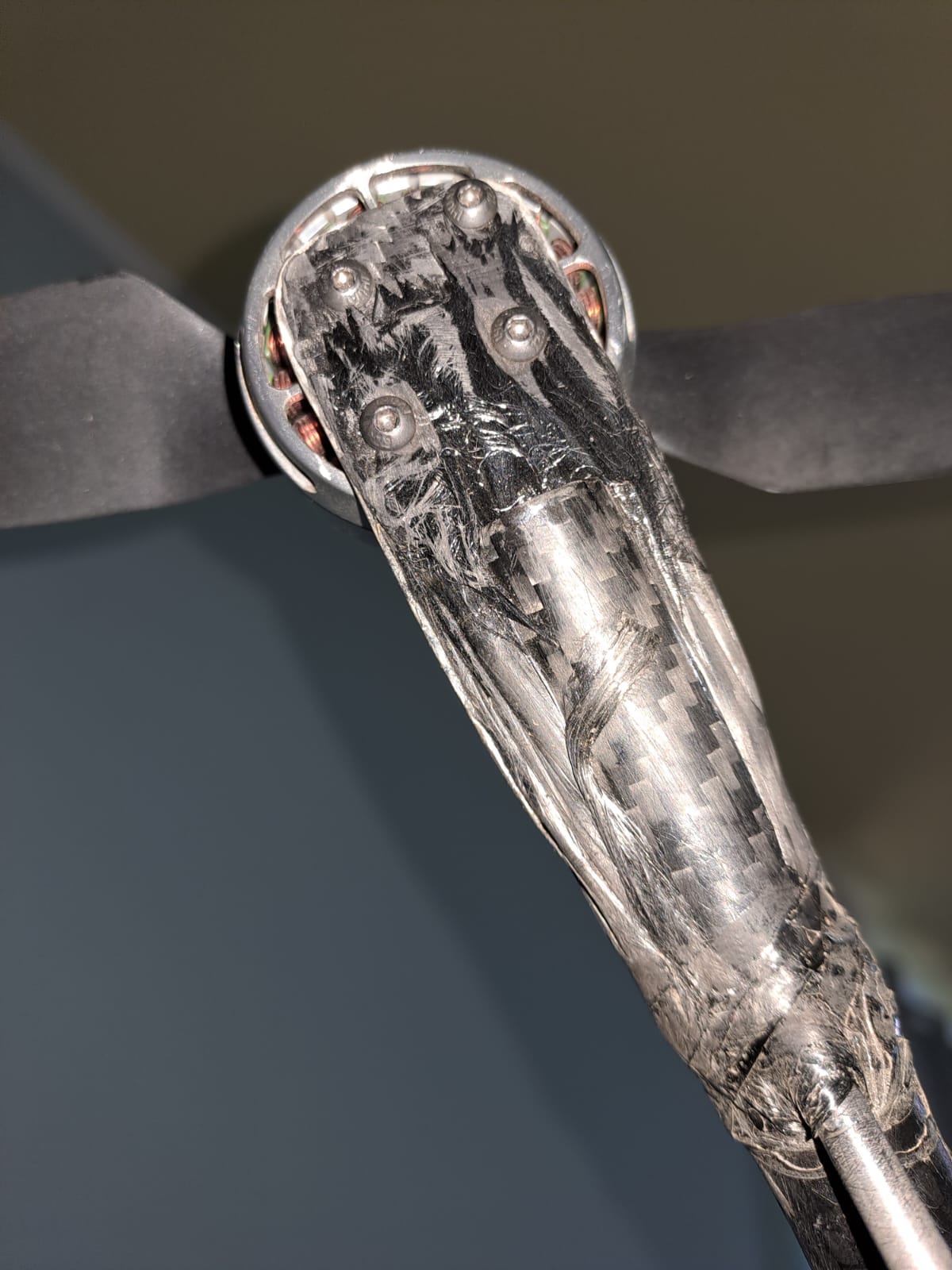

Frame: DIY balsa/fiberglass/carbon fiber sandwich construction with carbon fiber 250 mm arms with 16 mm o.d., with root reinforcement of 18 mm o.d.

The arms: permanently glued to the main board, it looks rather shabby, but very effective and very light weight, much better than bolted connections, about 6 grams per arm. The motor mounts are also glued in using carbon fiber tows and epoxy and weigh an extra 12 grams per mount. The frame/arm joint is very rigid, virtually impossible to twist.

I have two theories for that: it is either due to a too rigid connection between frame and arms or the arms are too slender. I am building another copter with bolted arms just to test out this problem. I am even thinking about placing a very thin soft material between the frame and the arms so as to prevent propagation of vibrations from arm to the frame and dampen them.
