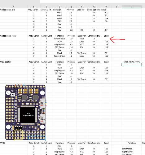

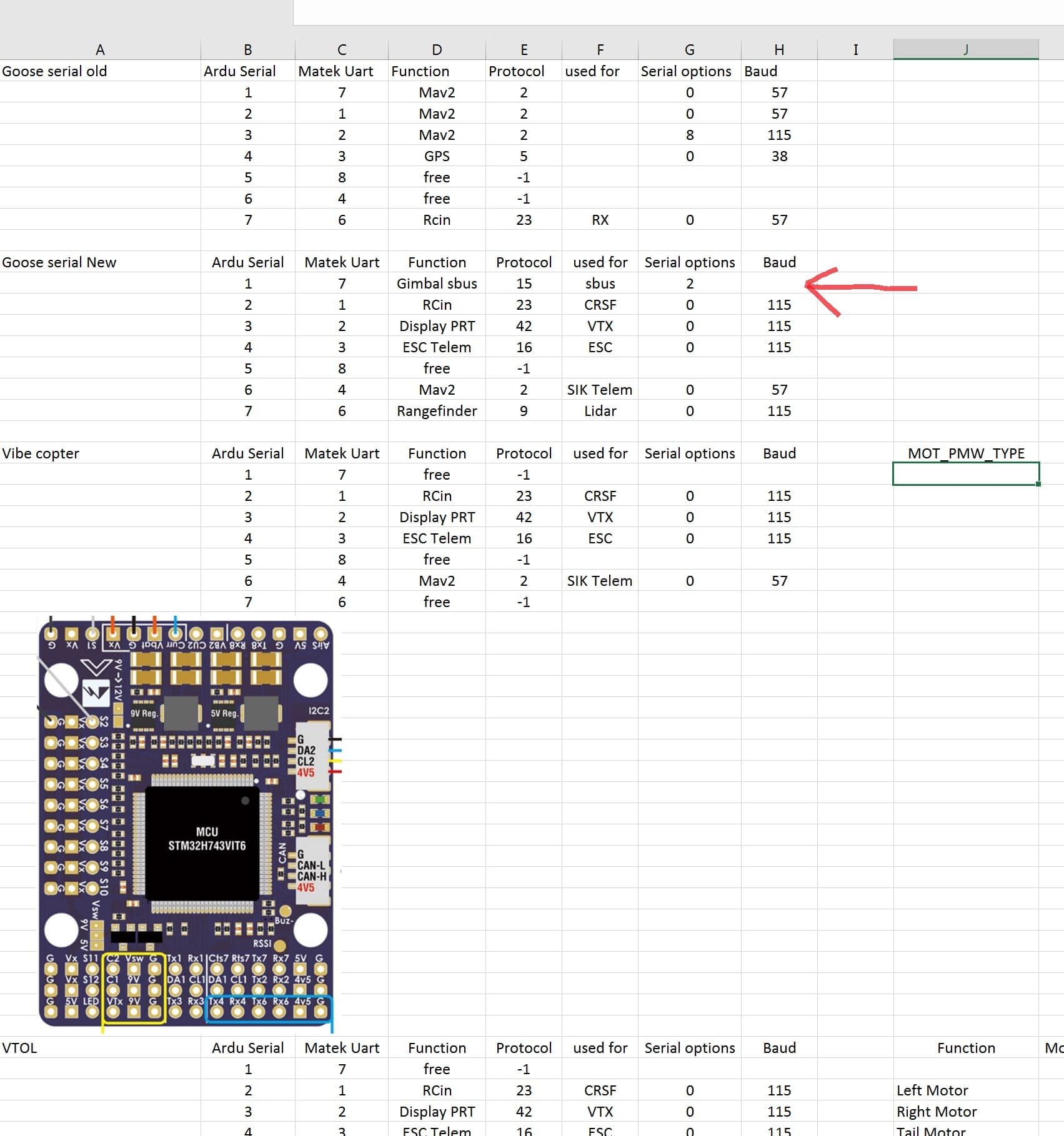

You can set one of the UARTS to sbus out. Connect the FC tx wire to the sbus in on gimbal.
As I said, Im not having a lot of luck with sbus. It works but causes terrible jitter compared to PWM control. There may be better firmware now. I haven’t played with it for a while.
Check my spreadsheet for ardu settings. Mine is for the matec H743 but you can see the sbus port settings.
