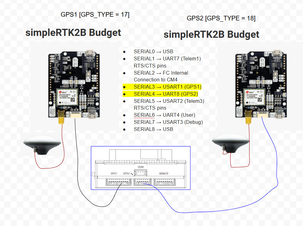

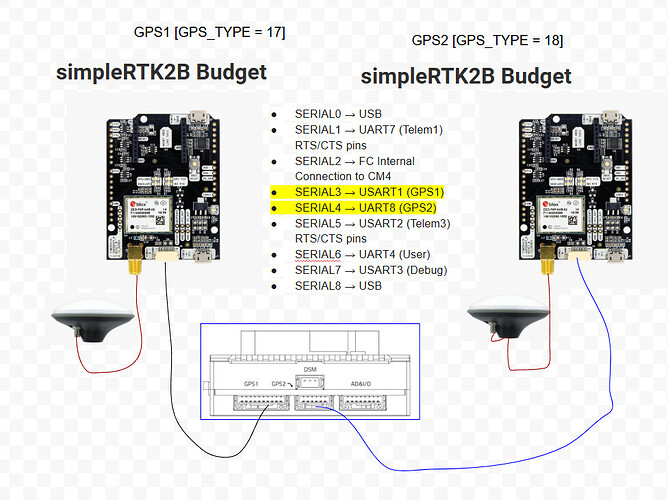

Let’s start over here - EXACTLY which radios (model/type) are connected to EXACTLY which bits of hardware? Be specific.
(I don’t think we are using the same terminology to describe what a “radio” is - hence the question)
EDIT:
Oh, I’m sure I’ve messed up somewhere…
Best I could do on short notice:
Pixhawk 6X CM4 (without an RPi installed)
Are you still injecting the RTCM3 signal from base station by going through your ground computer and to the rover over the telemetry radio? It sounds like you now have additional radios on your mower. Are you trying to send the correction signal directly from the base station to the Ardusimple GPS card? If so, only one radio is needed in addition to the main telemetry radio.
Ok, so you have no additional telemetry radios (like XBee or LoRa) connected to the ArduSimple modules themselves?
And only one telemetry radio connected to SERIAL1, through which RTCM3 is passed from Mission Planner?
Correct - no xbee or LoRa or anything other than one telemetry radio (holybro 915mhz) from MP base computer with NTRIP connected to (fairly) close NTRIP broadcast station, to, pixhawk/Telem1.

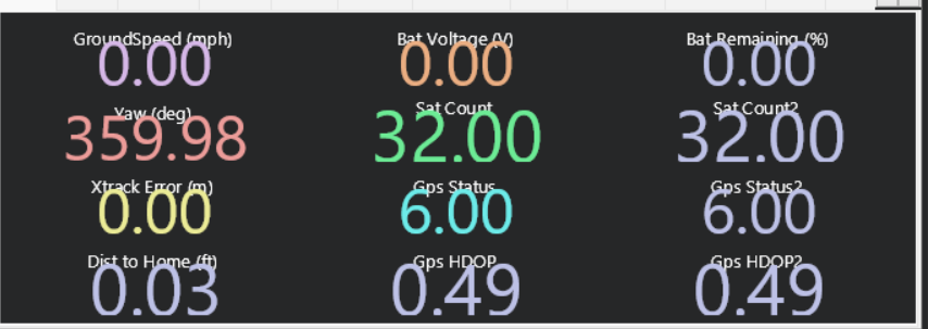

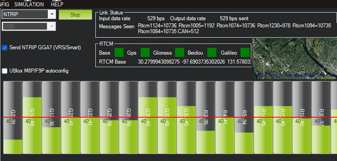

Get out your speedo - Just took a pass with the shredder down/back on the runway while system sat as you proposed above. gpsyaw2 in the 655.35 zone.

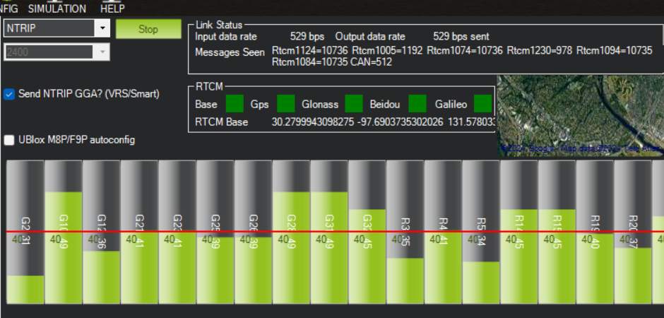

Were the NTRIP settings appropriate? Should autoconfig be on or Send NTRIP… be off?

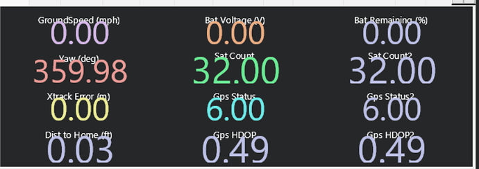

From the quick screen:

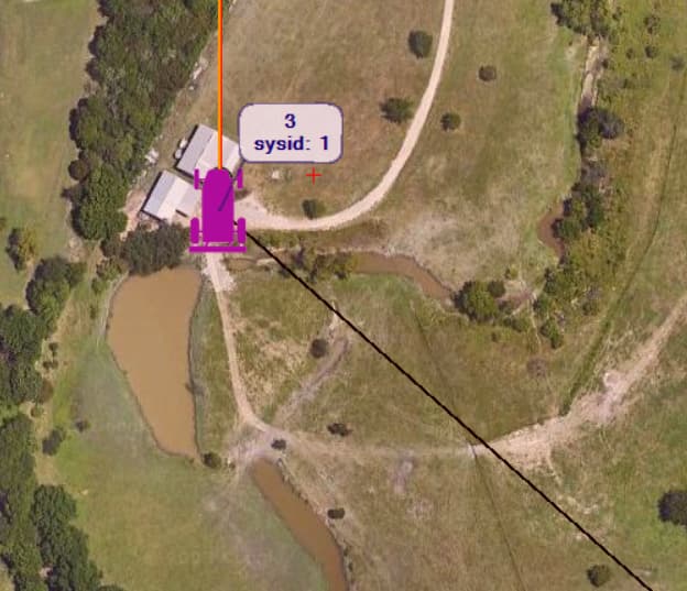

GPS Track in this pic is the approximate heading of the machine. Other current heading is not accurate:
On glossary - I’m trainable - got it now…
NTRIP appears to be fine and functional. Most checkmark settings don’t really matter except when you have a fixed base directly connected. The “send GGA” setting should probably be checked for most NTRIP applications (leave it the way it is).
Aaaand, NTRIP is immaterial to deriving heading with moving baseline (you could turn off external RTCM3 injects, and heading should still work).

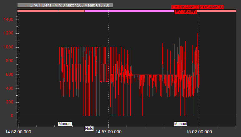

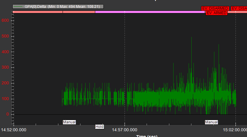

Another possible root cause (as observed in log 114):
This shows an extremely unstable update rate on GPS2. How long is the cable between GPS2 and the autopilot? Does it run alongside a high current/interference source? Or is it possibly a bad cable?
Even GPS1 shows an unstable rate, but it at least averages the 100ms rate that you demanded.
Need to see a log with GPS_RATE_MS* set to 200ms, as well.

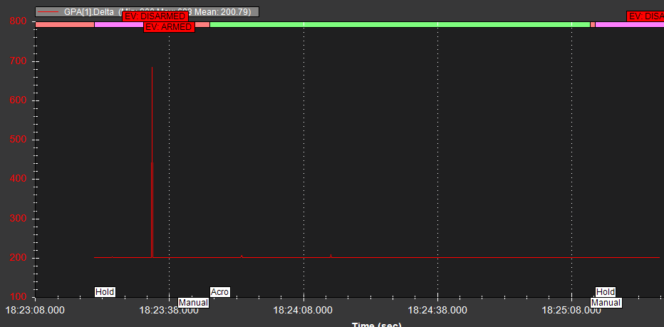

By way of comparison, here’s a sample log from my own ArduSimple based moving baseline config, showing near rock solid updates at 5Hz:
