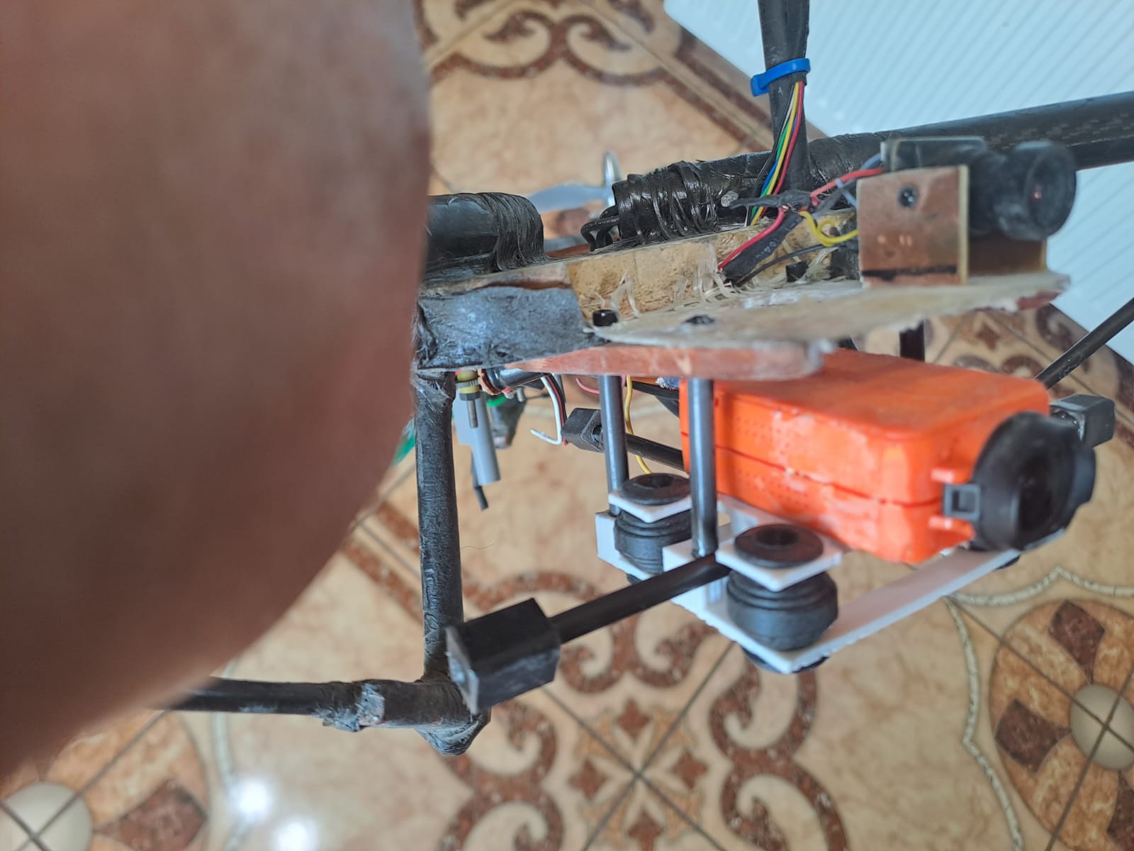

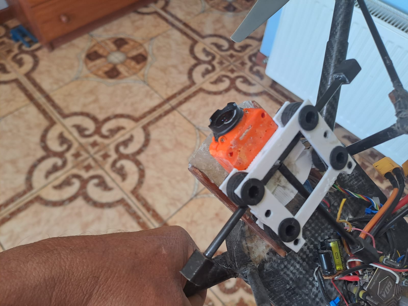

UPDATE of the DIY mechanical stabilizer…
I reworked it a little bit, changed stabilizer arms for carbon fiber, slightly increased the span (to 18 cm), slightly increased the weights (now they are 10, 10, and 12 grams, rear one), put rubber shock absorbers and voila, I have zero visible vibrations/oscillations… Obviousy, rough air produces video instability, but it is of a different kind and certainly could be corrected with a normal gymbal…
Total weight - 56 grams without camera, which weighs an extra 34 grams…
Now I am thinking about buying Siyi8… Not sure if it is a good choice…
