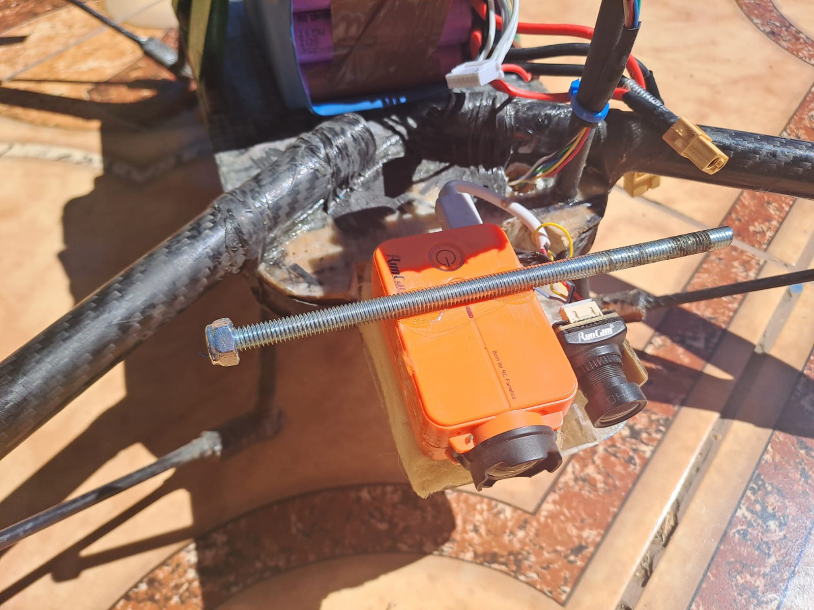

I am trying to solve the shakiness/vibrations of the HD Video. Right now I have an old Runcam mounted on a simple sponge, and I have several types of vibrations which are apparent in the video. Since I do not have much experience with copters and video stabilization I wanted to ask here what is the best way of solving it.

Yes most issues on your video, are from vibrations.
Add weight to the camera, that will make a quite efficient “poor-man” image stabalizer.
Thanks, will try doing so. More weight is the same as making the sponge softer…Would a gymbal be able to eliminate these vibrations?
No its not the same as making the sponge softer. Its better than that.
Goggle “mass dampen system”
No, for high frequency the gimbal itself needs to be dampen.

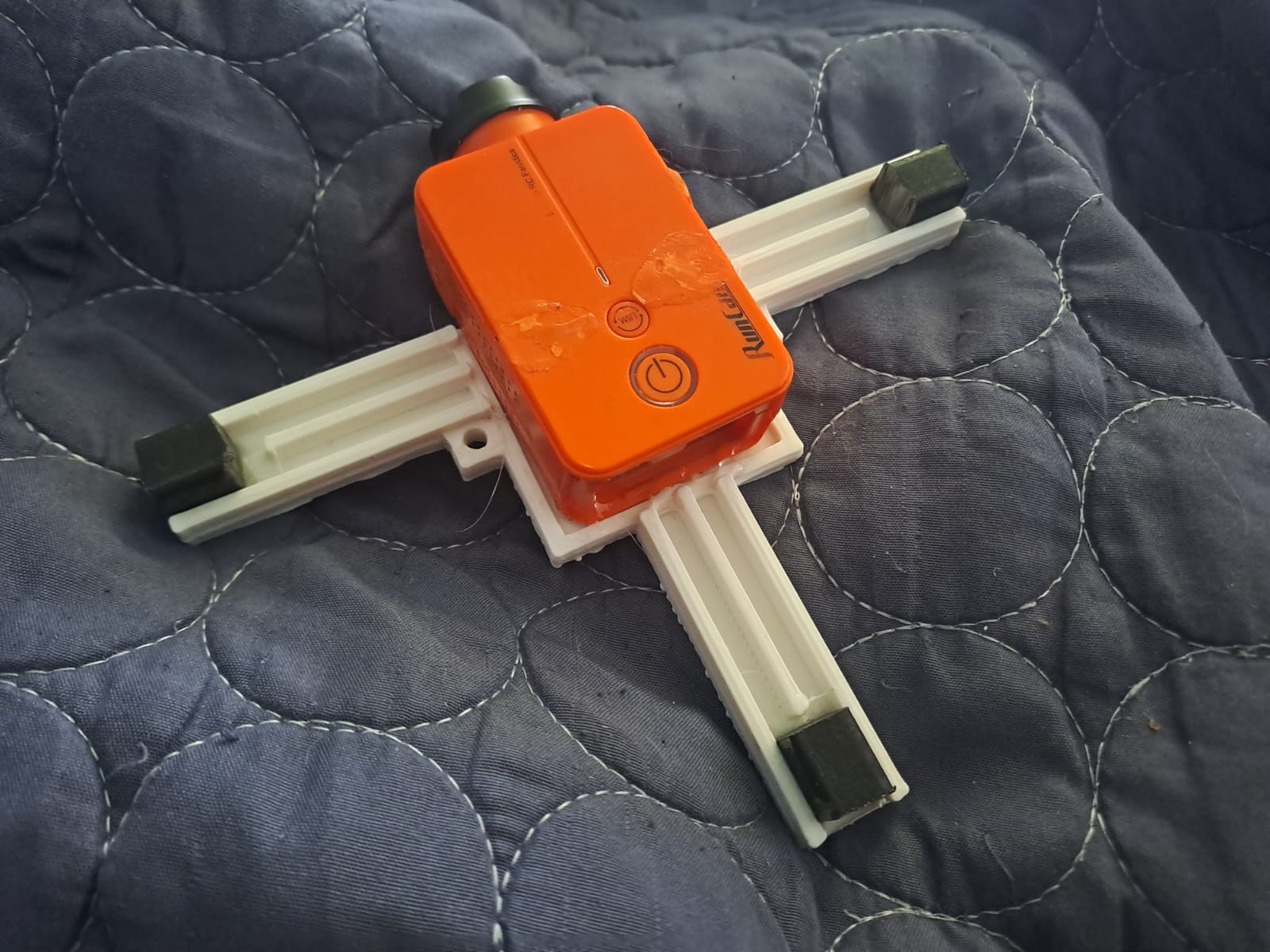

I tried putting something like this:
Weight 24 grams, that cut transversal (roll) oscillations by more than 70 %, and reduced putch oscillations by about half. The video now is not perfect but quite usable.
I am thinking of making a lightweight cross with weights at the tips and I feel that could eliminate the video vibrations almost completely!
I think I got it right:
This setup is a 3d printed stabilizer, 19 grams, with 3 x 9 gram weights, for a total of 50 grams. That eliminated about 80 % of the visible oscillations. Only on high speed descent and above 65 km/h horizontal flight slight oscillations can be seen, but it is a far cry from what I had in the lake video…
If I wanted to improve it, I would replace the frame of the stabilizer with carbon fiber to get more rigidity and less weight, and probably would extend it 1…2 cm, out (right now it has a span of 150 mm)

What foam did you use?
OK. I will upload shortly. The foam is a simple carpenter foam used for stools, very similar to the sponges used for dishwashing.
The way it is installed now is below, to get rid of the props, but I still got them in the view…
I do not trust 100% the foam/instant glue combination, so I put extra green ties just in case…
