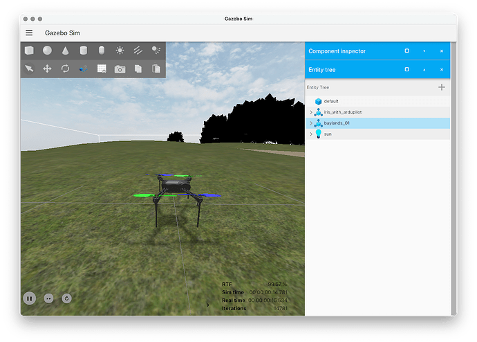

I’m attempting to run an Ardupilot-Gazebo simulation using the baylands world downloaded from fuel (https://app.gazebosim.org/VentuRobotics/fuel/models/baylands).
The simulation successfully loads and renders (image below), but the real time factor is extremely slow (~5%). The standard iris_runway world runs at ~90%.
Are there any particular techniques I need to be using to have this run quicker on my machine? I’ve left my specs below. What’s confusing me is that the sim doesn’t appear to be using all of my system resources (~40% CPU and memory). Do I have to explicitly set gazebo to use my system’s gpu?
I’ve tried adjusting reducing the <max_step_size> from 250hz to 100hz, but the copter becomes unusable. I’ve included my base .sdf file below for reference on the plugins being employed.

Hi @jamisonpereira, the slowdown is caused by the collision mesh of the gimbal in the iris_with_gimbal model. Using the model without a gimbal, which uses primitives for collisions, there is almost no slowdown:
    <include>
      <uri>model://iris_with_ardupilot</uri>
      <pose degrees="true">0 0 0.5 0 0 90</pose>
    </include>
The problem collision objects are in gimbal_small_3d
      <collision name="roll_collision">
        <geometry>
          <mesh>
            <uri>model://gimbal_small_3d/meshes/roll_arm.dae</uri>
          </mesh>
        </geometry>
      </collision>
and so on. The solution is for us to add a low poly mesh, or better collection of primitives to approximate the object.
Issue raised here:
Thank you @rhys. Looking forward to the new feature.
I got the same results as you when running with iris_with_ardupilot – the sim runs normally. FYI, in my iris_with_gimbal.sdf the gimbal_small_2d is attached (not the 3d; see below). But I assume it would have the same issue with collision objects you described.
