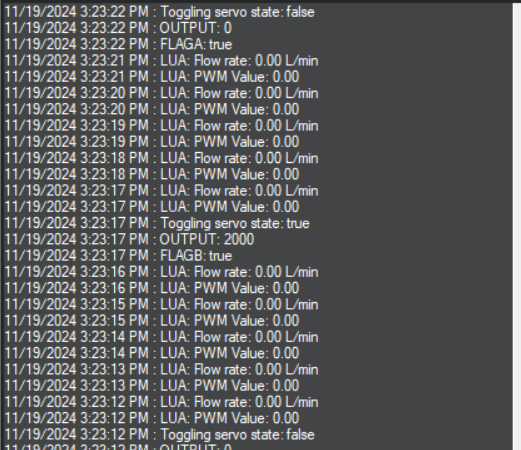

Hello, I’m currently attempting to configure a a flow sensor to be able to turn off my mosfet switch for a sprayer tank on my Pixhawk 6c.
Right now I’m just trying to test to get an out from the flow sensor, and push output of voltage change onto my mosfet whatsoever and having no success.

For the Mosfet Port:
I have it on I/O PWM 8, with the lua script running on 94, and it is correctly changing the PWM values just fine(right now I have it from 0 and 2000) in attempts to turn the voltage on/off(so I can have it work for the mosfet switch eventually, but right now its just some wires out putting and testing on a multi meter. But even then the voltage is just always staying the same. (Also its only pulling ~.02 to 0.033 V not the supposed to be 3.3 V)
For the Flow Sensor Port:
I have it on the I/O PWM 7, with the lua script running on 56(RCIN 6) as it is outputting a square wave pulse output signal.
But currently even when I have it all hooked up, its reading the PWM of zero on the port(as in correctly configured in mission planner to RCIN 6). But whenever I put water through the sensor its not reading the flow rate, or even the frequency whats so ever currently. Just stays at flat 0’s for both which doesn’t seem right, as when we test the flow sensor separately it’s properly outputing.

Message Console Output:
The one big issue we are realizing currently could be the fact it is only outputting such a low voltage, as the flow sensor needs 3 to 24 VDC to be powered in general. So if that likely seems to be the issue, then that’s a whole different issue to attack as well, so open for ideas on that as well.
You got things fundamentally wrong with the flow sensor.
RCINx means that it will directly output the value of RC channel x.
You can use battery monitor for monitoring your sprayer tank (treating it as a fuel tank) and then use lua script to monitor that.
Use the RPM input and the RELAY output
