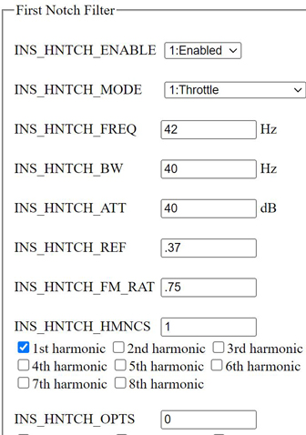

OK, you can at least set the Notch filter now.
Notch
That battery is sagging pretty fast. As seen in the previous logs you will lose Stability quickly. launch it and switch to a forward flight mode.

Looking at the log would ins_htch_hmcs 5 help? Looks like one spike is happening after the 1st notch. Clicking 3rd harmonic check box seems to cover it? Still learning. Im really liking aurdupilot over inav.
