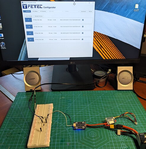

Hi. I need to figure out, if half-duplex is working now.
I made a quick video, how it is working with a USB-Serial adapter, that does not support half-duplex. You need a diode for this:
I just tried if the passthrough is working with a attached logic analyzer with a cube orange plus and FETtec 65A. If I enable half-duplex there is no outgoing communication from the cube, in passthough-mode. If I disable half-duplex I see correct traffic on tx, but the ESC needs half-duplex for the configuration mode. Without halfduplex and 2000000baud it is not possible to reach the configuraton mode atm. I believe you will reach the configuration mode with the USB-Serial adaptor faster.

You do not need to connect the motors to flash newer firmware or configure the ESCs. But you need to supply voltage on BAT+ and BAT-.
Windows shows not all supported baud rates. I am using a cheap one with a CH340G chip. It is called “SDS011_USB2TTL_004”. I also used an Arduino UNO, where is connected Reset and GND to bypass the Atmel and other dongles. Some USB-Adaptors have RX and TX swapped. Maybe you can check that.
If you use half-duplex then the baudrate should be 2M baud (Connection via diode is also half-duplex, because the ESC sends half-duplex). If you use full-duplex its 500000 baud.
1N4007 is exactly what I used in the video and should work.
Please also check if the motor-screws are to long and connect the phases to your frame. That can cause the random stutter.

Using a new ESC, I was able to get the Configurator program working using your wiring:
I set the baud rate of my serial port to 115,200 and that worked fine. I tried several other baud rates - and they all seemed to work.
I did have to update the firmware for the settings to work. I would get dialog box warning that the serial port connection was unreliable until I updated the firmware. The firmware that came on my ESC was 1.0.84. The latest firmware is 1.0.224. That worked well - and I am able to adjust setting for all four ESC.
The problem we had with motors “stuttering” on start up was solved by removing the “slow start” feature in the configurator. Our motors also required setting the minimum motor to 6% in Mission Planner for reliable starts.
Even when setting the motor minimum to a very high setting - like 40% - the motors would still sometimes “stutter” on startup. It appears that the “slow start” feature can simply be too slow for some motors.
