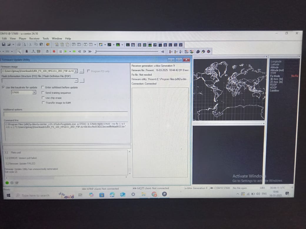

Hi friends,
I have been developing a autonomous rover with simplertk2b as a base station. So to set as a base station after a survey in. I surveyed the gnss receiver with the gnss antenna in an open sky. But it hasn’t changed to time mode after the survey in process. So, then I decided to change my old version 1.13 to new version of 1.51 from ublox website. but now I’m facing this error from my side
Setup pipes
Process launched
-p STDIO -b 57600:9600:57600 --no-fis 1 -s 0 -t 0 -v 1 “C:\Users\jpmag\Downloads\UBX_F9_100_HPG151_ZED_F9P.6c43b30ccfed539322eccedfb96ad933.bin”
----------CMD line arguments-----------
Image file: C:\Users\jpmag\Downloads\UBX_F9_100_HPG151_ZED_F9P.6c43b30ccfed539322eccedfb96ad933.bin
Flash:
Fis: flash.xml
Port: STDIO
Baudrates: 57600/9600/57600
Safeboot: 0
Reset: 1
AutoBaud: 0
Verbose: 1
Erase all: 1
Erase only: 0
Training sequence: 0
Chip erase: 0
Merging FIS: 1
Update RAM: 0
Use USB alt: 0
0.0 u-blox Firmware Update Tool version 23.11
0.0 Updating Firmware ‘C:\Users\jpmag\Downloads\UBX_F9_100_HPG151_ZED_F9P.6c43b30ccfed539322eccedfb96ad933.bin’ of receiver over ‘STDIO’
0.0 - Opening and buffering image file
0.0 - Verifying image
0.0 - Got an encrypted image with footer info
0.0 - CRC Value : FFEE16BA
0.0 - Footer Version : 0
0.0 - Number of Images : 2
0.0 - Footer Size : 28
0.0 - Image Config Size : 0
0.0 - Image 0 Size : 766056
0.0 - Image 1 Size : 588540
0.0 - Trying to open port STDIO
0.0 - Setting baudrate to 57600
1.2 - Retry poll
2.2 - Retry poll
3.2 - Retry poll
3.2 ERROR: Version poll failed.
3.2 Firmware Update FAILED
Firmware Update Utility has unexpectedly terminated
Exit code (2)
kindly help me with this. I have restarted the system uninstalled and re-installed the ucenter software, even dumped the old firmware 1.13 again but the error still persists.
