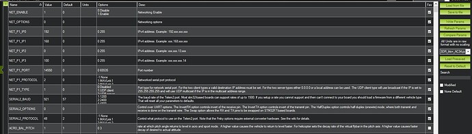

I am trying to get the Ethernet using PPP on serial working on the Pixhawk 6c board from Holybro. I had to do a custom build with the networking options enabled. The link for my firmware is here I have set my pixhwak board using the following settings and I am using the TELEM2 port

I also have the net_test.lua script in the APM folder on pixhawk-6c
I can ping from Raspberry pi to the Pixhawk IP address
$ ping 192.168.0.100
PING 192.168.0.100 (192.168.0.100) 56(84) bytes of data.
64 bytes from 192.168.0.100: icmp_seq=1 ttl=255 time=2.11 ms
64 bytes from 192.168.0.100: icmp_seq=2 ttl=255 time=2.17 ms
64 bytes from 192.168.0.100: icmp_seq=3 ttl=255 time=2.27 ms
However, now on my laptop if I open up a browser and navigate to http://192.168.0.100:8080 I don’t see anything and get the following error.
I have also tried connecting mavproxy over UDP from the raspberry pi using the below command and that fails too!
$ mavproxy.py --master=udp:192.168.0.100:14550
Connect udp:192.168.0.100:14550 source_system=255
Failed to connect to udp:192.168.0.100:14550 : [Errno 99] Cannot assign requested address
Can someone please help me on this ? Any help would be greatly appreciated.
@tridge Tagging you so that you can see if I am doing anything stupid.
Thanks again!
