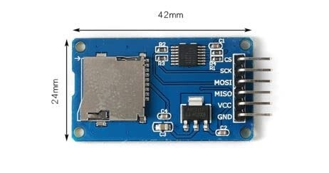

i have HW-125 module. And i think that must to be connected only SPI.

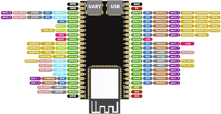

The pinout of my ESP32-S3 is this:
@Juergen-Fahlbusch i have big dubt..
wich pin i must set for CS pin of HW-125 ? and wich name of SD-CARD when is set ESP32_SPIDEV ?
for now i have used pin GPIO_5
this is the code that i use for sdcard:
#ESP32_SPIBUS SPI3_HOST SPI_DMA_CH_AUTO GPIO_NUM_ GPIO_NUM_ GPIO_NUM_
Host DMA Channel MOSI MISO SCLK
ESP32_SPIBUS SPI3_HOST SPI_DMA_CH_AUTO GPIO_NUM_36 GPIO_NUM_37 GPIO_NUM_35
SPI Devices
Name Bus Device ChipSel Mode LoSpeed HiSpeed
ESP32_SPIDEV sd-card?? 0 0 GPIO_NUM_5 0 2MHZ 8MHZ
update: i have set
ESP32_SPIDEV SDCARD 0 0 GPIO_NUM_10 0 2MHZ 8MHZ
but not connect the same…
in ESP32 nodemcu i dont have set the SDCARD then i think is not this the problem..
The SDcard SPI should be not the same as the DeviceSPI
I have following entries at HWDEF:
#-----SDCARD
define HAL_ESP32_SDSPI {.host=VSPI_HOST, .dma_ch=2, .mosi=GPIO_NUM_23, .miso=GPIO_NUM_19, .sclk=GPIO_NUM_18, .cs=GPIO_NUM_5}
define HAL_ESP32_SDCARD
define HAL_LOGGING_STACK_SIZE 4096
define HAL_LOGGING_FILESYSTEM_ENABLED 1
define HAL_LOGGING_DATAFLASH_ENABLED 0
define HAL_LOGGING_MAVLINK_ENABLED 1
define LOGGER_MAVLINK_SUPPORT 1
define HAL_LOGGING_BACKENDS_DEFAULT 1
My pin definitions are based on the pinout of the ESP_DevKit_C_V4 not on your ESP32 S3. The used pins are the predefined pins for VSPI bus.
On this board VSPI_HOST is a alternative name of SPI 3.
