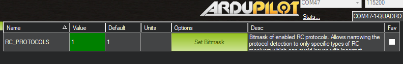

Hi
i have a problem with my Esp32 S3 using Mission Planner.
The connection is ok with Mission Planner but i cannot use receiver Flysky IA6B with Sbus protocol.
In my firmware i have put:
#-----RCIN-----
define HAL_ESP32_RMT_RX_PIN_NUMBER GPIO_NUM_14
define HAL_ESP32_RCIN GPIO_NUM_14
define AP_RCPROTOCOL_ENABLED 0
if i change in the firmware …define AP_RCPROTOCOL_ENABLED 1…but not connect to Mission Planner.
Only i can changed in Mission Planner.. putting:
but not work the receiver…and i cannot calibrate my radio Flysky I6.
how i can solve ?
thanks much

in Default.param i have put:
SCHED_LOOP_RATE 50
SIM_RATE_HZ 100
RC_Protocol = 1 is not SBUS but PPM
RC_Protocol = 0 is “All” Protocolls
Check if RC_Protocol = 3 (SBUS) is working

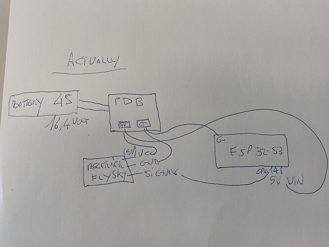

hi.
i have tried many protocols (SBUS, PPM and IBBUS) setting also on the radio, but not work.
This my layout of wirings:
can be that there are my mistakes on this ?
thanks much to all.

wiring looks correct.
Did you do as suggested by @Juergen-Fahlbusch , and if it doesnt work, use the same settings described by @Juergen-Fahlbusch along with
define AP_RCPROTOCOL_ENABLED 1 // currently it is at 0
I checked the esp32buzz hwdef and it doesn’t seem to be having anything like this in its hwdef, so maybe just remove this line altogether (not sure about these hwdef.dat changes)
